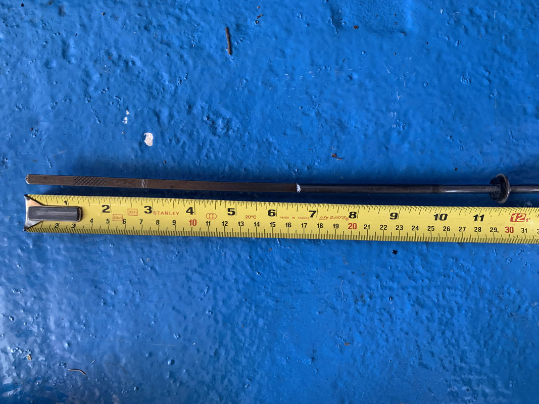

I've been reading up on previous dipstick and oil level threads.
My own dipstick is somewhat out of spec, too long from collar to oil level hatching and bottom of the dipstick, which may have led to my engine previously being under filled!
My dipstick measures 11.5 inches from the collar to bottom end (pic1) so is about 1.75 inches too long. Hence to an E Type novice the oil level would "look" correct BUT be waaaay low!
I'm wondering if the collar could have moved/been moved by some gorilla in the past? It seems pretty well fixed in its current position but I can't see a weld and haven't tried too hard to move it (back) down the dipstick.
At the collar end the dipstick is nice and shiny as if it hasn't been scuffed by years of sliding in and out of the block (see pic 3). IF the collar could be moved down the dipstick to where the shiny part finishes it would be the correct length (pic 4) which is why I'm wondering if it moved/been moved
What do you guys think? Has the collar moved or is it just the wrong dipstick?
Opinions welcome
Opinions welcome

#2 Re: Dipstick "collar". Can it move and how is it fixed?
If it is a correct E type dipstick it should have a capital E engraved on it . Whether it is correct or not, it looks to me as though the dipstick has slipped downwards through the collar . The one way really to tell is to drain your oil into a clear container, and then use it to refill the engine with a measure until you have put precisely 8.5 litres ( 15 imperial pints) in, and then use that ( after allowing perhaps an hour for the oil to drain down thoroughly ) to calibrate the stick at the full level
Ideally, once calibrated to the correct length then the collar can be soldered, but provided it is thoroughly cleaned, I would think that Araldite would be equally effective

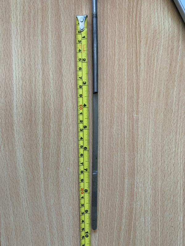

#3 Re: Dipstick "collar". Can it move and how is it fixed?
From our Factory Fit section:
viewtopic.php?p=45061#p45061
Note the felt washer needs to be in place for a correct reading. Part number C17585 available from SNGB.
From cap to top of hash marks....8 and 1/16th of an inch.
From cap to mid point of hash marks...approx 8 and 3/8ths of an inch
From cap to bottom of hash marks...a fraction under 8 and 11/16ths of an inch
From cap to bottom of dip stick 9 and 3/4 inches
The hash marks cover a length of 19/32nd of an inch.
There is also an E stamped about 9 and 7/16ths of an inch from the cap
Oil level is just about the top of the hash marks when engine is cold....
All measurements with a good quality steel rule not a cheap tape measure..

#4 Re: Dipstick "collar". Can it move and how is it fixed?
Looking more closely at your lower photograph I can see an E on the stick, so it is the correct item but has slipped downwards. My earlier post should have suggested silver soldering , not soldering, as a remedy
#5 Re: Dipstick "collar". Can it move and how is it fixed?
Thank you chaps. With a few light taps on the collar I was able to slide it down the dipstick to the correct position I shall solder it in place.

#8 Re: Dipstick "collar". Can it move and how is it fixed?
Thought I would check my dipsticks and adjust as necessary. But come up with a few differences for later 4.2 engine.
Both have the E at the above distance down from cap, one is the later S2 type with the red disc which is effectively one long half round rod bent double. The other an earlier one with a riveted in bottom section added to a solid rod.
Hash marks on both 3/4 inch (or 24/32 not 19/32)
Cap to top of hash marks 7 15/16ths
Filling with correct amount of oil brought the level to top of hash marks and, yes, the felt washer is on the stick.
Measured with a good quality steel rule.
Any thoughts or comments?

Looking at a 1997 copy of Haddock page 102-103 would suggest the one dipstick is “The early flat dipstick. The flat stick is inserted into a slot in the handle, and retained by two rivets.” For engines before R9699, about February 1963.
So for a 3.8 engine, interesting to find in my S2 built 1969. And it has a dot pattern at the oil level area rather than the hash marks.
#11 Re: Dipstick "collar". Can it move and how is it fixed?
Uh yes Geoff...you can rely on me .....photo from the knowledge base.......only worth quoting measurements to 1/16 in if you quote how thick your felt is
- Posts: 3323
#12 Re: Dipstick "collar". Can it move and how is it fixed?
Steve, as our leader/headmaster quoted from the cap not the felt I did the same
Many thanks for that photo, now to find someone willing to pay me lots of money to get their 61 or 62 car absolutely concours
