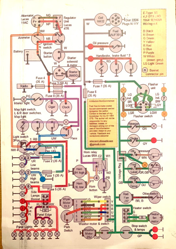

#13 Re: Rev counter
No Geoff I did not see if horn or brake lights were working but everything was a few days prior, anyway it dumped a lot of coolant so obviously something amiss. Will check.
Thanks for responding and DWW for the wiring diagram

#14 Re: Rev counter
Danny's wiring diagram is not for your car, John, but is for a S1 4.2
