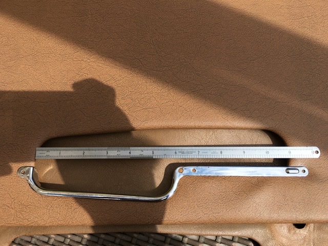

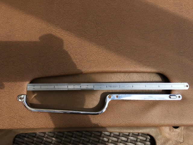

In the area of the recess, the length of the cutout on both the old and new door cards is the same, 11 inches. The rear edge of the new one is more curved than the original though. I’ve managed to glue the original plastic recess, so think I’ll just fit that for now as it fits better and will match the driver’s side.

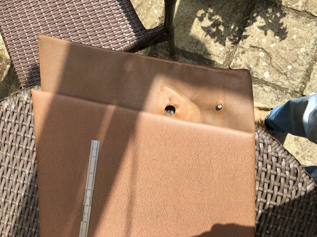

The door card itself isn’t great in a few areas. Firstly, it’s made from a series 1 door card, with the extra cutout added to make it a series 2. This doesn’t go as far as including the extra holes for the rivets that hold the chrome strips on. The chrome strips on the S2 are a different height to the S1, so the holes don’t line up. It’s also a fair bit taller than the original too. It must be possible to make it fit as the driver’s side was fitted by the previous owner.

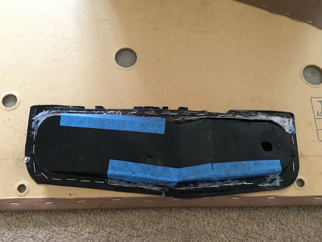

I decided to repair and reuse the original recess for now, as it matched the new door card better. It will all have to come apart at some point again in the future when I eventually paint the car. Superglue, and some sewing tape glued to the back has successfully repaired it.
I’m not entirely sure what came off was factory original anyway. There were 2 small self tappers under the chrome strips to hold the door card on. These aren’t mentioned in any manual, and would have meant fitting the chrome strips with the door card fitted to the door. It was tricky enough to fit on the bench, let alone on the car. The leading edge of the front chrome was bent over where it had been tapped along to pick up the rivets. I doubt the factory would have delivered the car like this. Finally, there were 2 styles of clips used to secure the door card to the door. Again, not what I’d expect from the factory.
