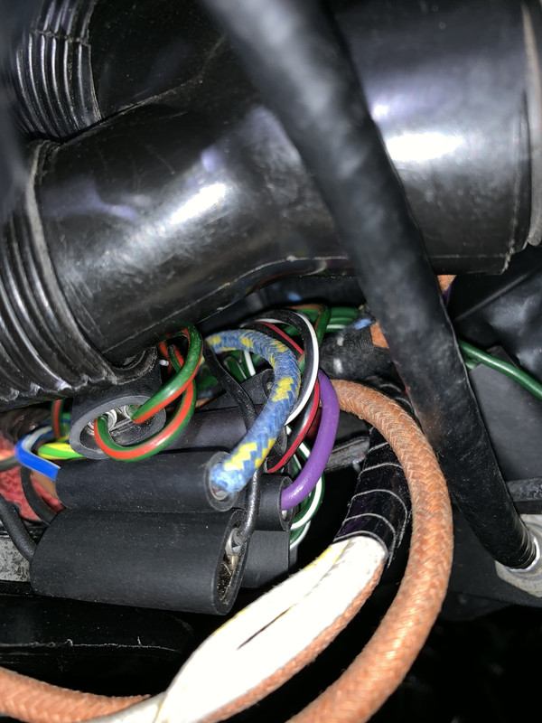

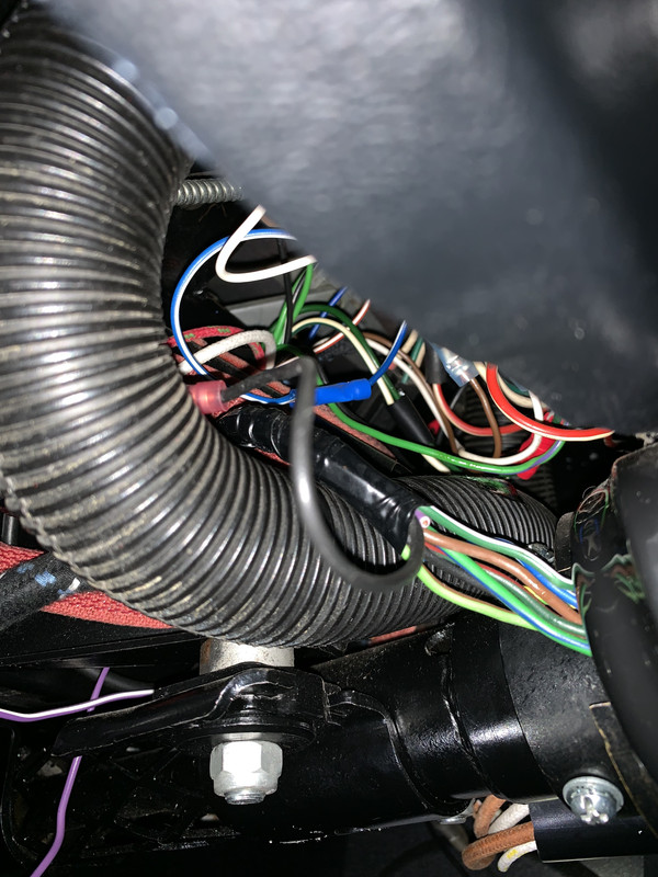

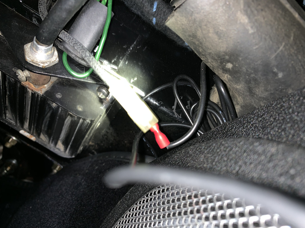

Post by Tbob » Mon Feb 15, 2016 11:46 pm
heres some pics from the driver side footwell.
Bob t
LHD '69 OTS. (Former) basket case

FHCINSC wrote:
Thu Dec 13, 2018 4:24 am
Is there another place behind the gauge panel that these could be reversed?
Yes, at the base of the LHS A pillar by the indicator flasher unit. If you have a look at the second photo in post #7 in this thread, it shows the set of bullet connectors you should check as I suspect this is where you'll find your problem.
