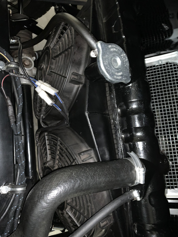

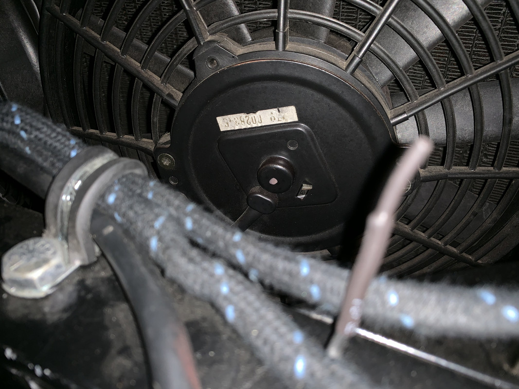

Just curious if anyone knows which fan this is on my car.

They’re not standard S2 fans. They’re probably a standard size Spal fan or similar from a catalogue, rather than off another car. I expect they shift more air and draw less current than the originals. The only downside is they don’t look particularly period correct. Do they work alright?

Yes Tom they do work well. I realized earlier today they were blowing the wrong way. Reversing the wiring fixed that. Now they blow air from the radiator toward the engine. I presume that is right.
I will still be planning to recore my radiator because of 90 degree SC weather that will be here before I know it.
Thanks much!
