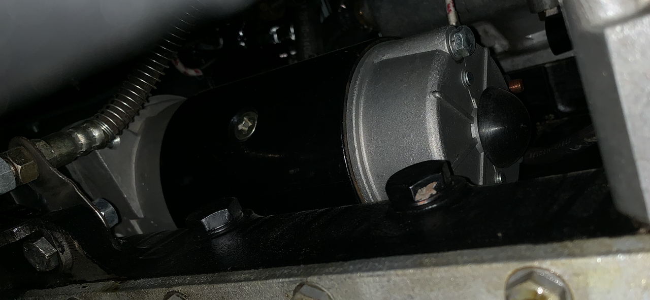

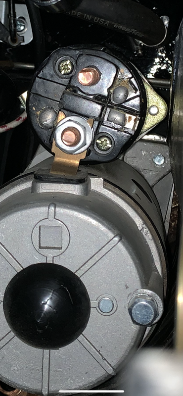

My starter motor has the 12 V wire coming from the battery and it has the White Red wire coming from the starter relay.
This picture points to where the standalone wire was connected. So basically it made a jumper connection from the white yellow wire at the starter relay to the starter solenoid.
At the moment I am wondering if I have a problem at the ignition switch, the fuse block or if the starter relay is bad.

I have noticed that the starter motor seems to not disengage upon starting the car. It is not so much that it is continuing to try to start the car but it just sounds like the gearing doesn’t disengage from the fly wheel for the first 15 seconds or so.
A retired friend who owned a starter and alternator shop suggested that this is probably the solenoid. Either it is faulty or it is continuing to receive voltage.
The car has all new wiring harnesses which is nice but the previous owner did a fair amount of carelessness with electrical tape when making connections. One such thing that I noticed was that there was a strange stand alone wire going to the starter solenoid and it was connecting inside the car in a Y with the white/yellow wire on the starter relay. It is very clear that this wire didn’t belong there and it was routed rather poorly and probably was a reasonably good fire hazard.
I reviewed the wiring diagrams for the starter and for the starter relay and it appeared there was no need for this extra wire. However upon removing it the car will not start now at all.

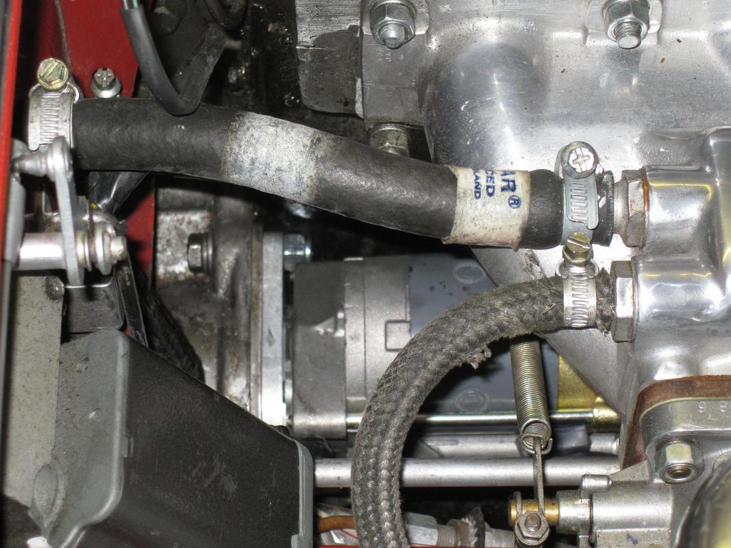

Hi Anthony.....is your starter motor a replacement...it looks like it is......an original has a spacer plate fitted between the motor and the bellhousing......without it you could have engagement/disengage problems....also some aftermarket replacements can have different angle teeth....another potential problem....re the wireing do you have a ballast resistor start system....this will have a seperate thinner wire from the solonoid ....have a look at this diagram.....

Thanks Steve. I do not believe I have the ballast resistor because I believe I researched that before and those showed up after my car was built.
Also I don’t have a white and blue wire like your diagram mentioned. I have brown, white/red, and white/yellow at my relay (And I believe black).
I don’t know if I have the spacer. I’ll try to take some more photos in a bit.
I don’t know if the starter is replacement but it may be. It certainly looks new but I don’t have a receipt for it.
It’s either new or rebuilt/restored.

It looks from your photo that your white-red wire is connected to the same terminal as the main battery positive feed. If that’s the case, then the car won’t turn over as you’re just connecting the switched 12v feed to a point that already has a permanent 12v. On the original ballast resistor wiring, the extra feed that bypasses the resistor when cranking comes from the relay, not the starter motor. If you have a replacement motor, there might well be extra connections you don’t need for your installation.

Hi Tom.....looks like an insulator on that stud the battery cable is connected to...isolating it from the r/w...Steve

Hi Tom. Yes. There was a stand alone and badly made/routed wire that connected that terminal into the starter relay on the same connection as the white/yellow wire that goes to the ignition.
The car won’t start now that I removed it. Obviously I know how to fix it but I’m trying to figure out why it’s this way and it doesn’t match the wiring diagrams.

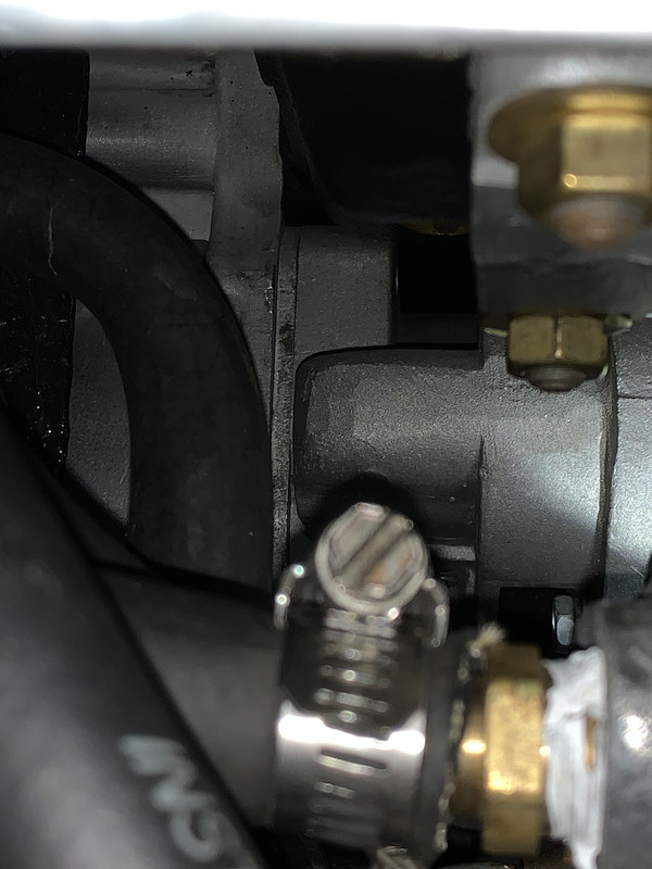

Well. Photography is a real challenge without removing some items.
Here is a shot from under the car. Won’t help with the wiring but maybe could help determine if the spacer is there.

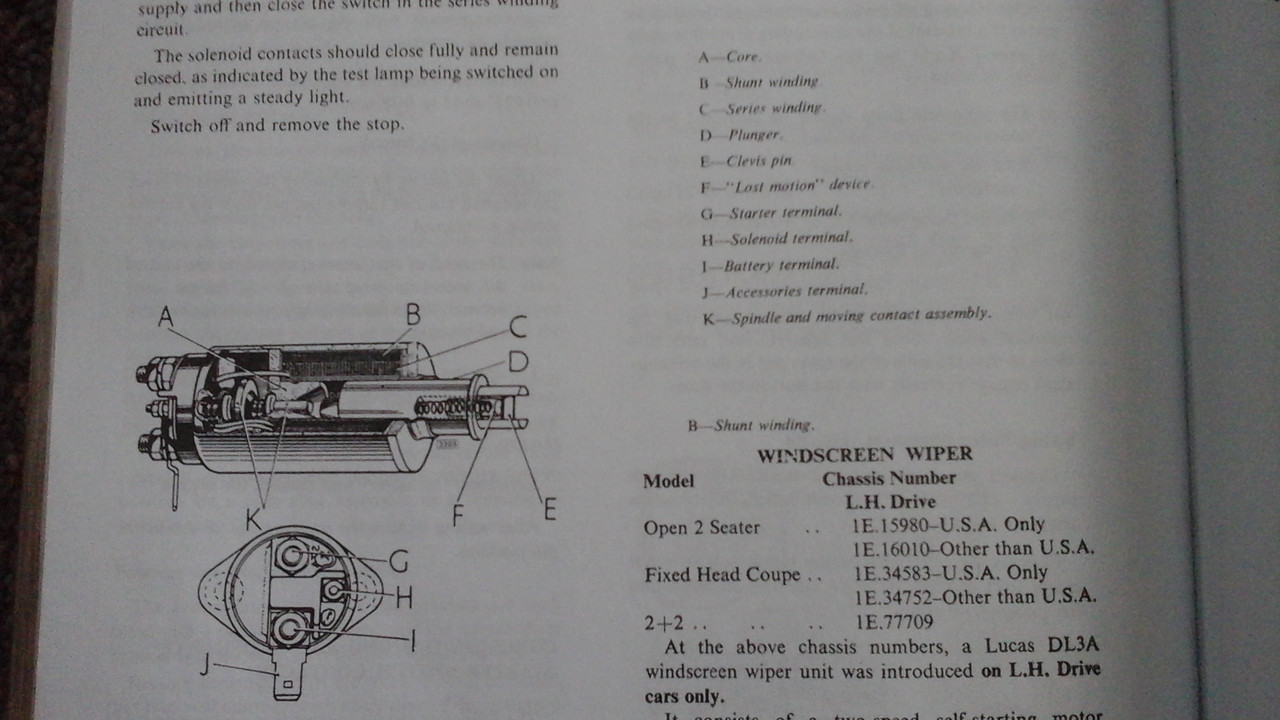

Hi Anthony...lets take a step back.......was you starter motor working ok then started to not disengage..or been like this since you had the car......here is a photo showing the spigot plate inbetween the starter and bellhousing
This is from the service manual showing solonoid connections
From your first photo with the arrow we cant really see the H terminal as shown in the diagram above......im assuming its connected to the smaller terminal with the arrow.......this should have the feed from the relay to operate the sololonid.....i suggest the r/w may be used as a power take off to feed power to the relay....possibly the previous owner swapped the wires at both ends..if the motor was changed and the terminals were different sizes......there looks like an insulator on the top stud....is the r/w connected to or insulated from it..Steve

Hello all
I decided to remove the assembly of nuts and washers and connectors on the solenoid post.
I found that the terminal that the random homemade wire was attached to looks to be soldered onto the solenoid.
I took the white/red wire and moved it to this soldered on terminal and the car starts. However I do still have the trouble with the starter not disengaging immediately....this problem has been there since I took delivery of the car.
I’ve also confirmed that the white/red wire voltage drops to zero when the key is released. So I think my ignition and relay are good.
I’m going to guess I need a new solenoid.

Hi Anthony...yes thats the spacer in place.......cant quite see on your photo of solonoid but are there spade terminals soldered on.....so....good that you now have it working......probably worth taking out the starter motor and testing it on the bench to see if it releases ok....not sure why you think you need new solonoid..Steve
#16 Re: Starter wiring and solenoid questions.
To the right on the above pic is a small spade. That is where the white/red should go. The thick cable from the battery and a quite thick brown go to the top copper stud.

The brown wire will go to a stud somewhere near the battery then. The white red wire goes to the small spade and the battery cable to the copper post.....
