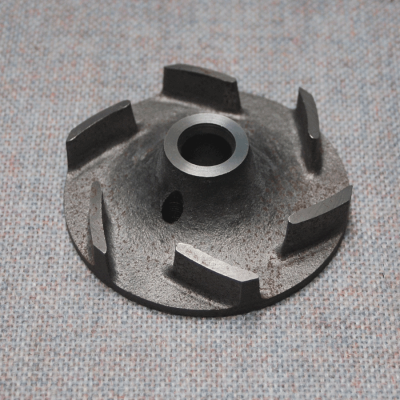

What I’ve learned about water pumps; here are pic’s of the pump impellers discussed in this post; 1st/2nd /3rd = left/centre/right = top/middle bottom.
The 1st impeller, in “early” pumps (C39768), was quickly superseded. Seems (?) this impeller never had a unique part number and was never sold separately by Jaguar.
The 2nd impeller was in the “later” pumps (C34549) fitted after engine 7S7785. The 2nd impeller had part number C36363 and was sold separately, to enable early e-types to be upgraded. The benefit was higher flowrate. But it also had a simpler (cheaper?) shaft seal, required the impeller to be taller. With this seal the impeller clearance and shaft seal are not independent, this can lead to miss-fit, consequence is wearing of the end of the impeller causing leakage from the shaft vent hole.

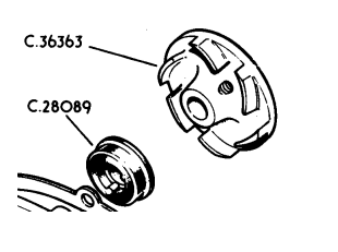

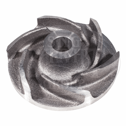

Here is illustration of the C.36363 (2nd) impeller from the Jaguar parts manual, along with pictures of what is claimed to be this from SNGB and XKs Unlimited catalogues, evidently XKs Unlimited sell the correct part while SNGB’s is the original (1st) impeller.
SNGB also offer an early-to-later water pump conversion kit. While this has the appearance of the later type, internally it is the early type (1st impeller). It is ironic that this early design, that Jaguar tried so hard to eliminate, is now the most common “upgrade”.
