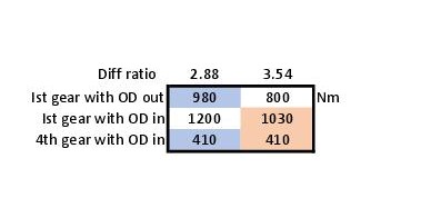

#37 Re: Laycock de Normanville
Remembering that, in lower gears, what you can have at the flywheel is limited to what will cause the wheels to slip (tyre “chirp”). To calculate you need to work backwards from the wheels, is a function of car mass, tyre friction coefficient and gear ratios (diff, OD, box). Nerd alert, lots of numbers ahead …Series1 Stu wrote: ↑Sat Nov 30, 2019 12:07 pmIf you ignore losses, whatever torque you have at the flywheel can simply be multiplied by the reduction ratio.
In first gear without OD, with 2.88 diff, slip will occur when the engine output reaches 330 Nm (80%). With a 3.54 diff it requires less, only 270 Nm (66%) to lose traction.
With taller diff, drive train (incl. OD) is more highly stressed. Using Marek’s bicycle analogy, with 2.88 diff he is having to stand in the pedals and push hard and slowly, compared to me with a 3.54, sitting back in the seat, little effort req’d despite legs like a thrashing machine.
1st gear ratio is 2.94. With 2.88 diff the torque from the gearbox = 330 x 2.94 = 980 Nm, with 3.54 it is “only” 800 Nm. These are the torques from the gearbox when there is no OD or when the OD is “out”.
Now consider with OD "in", in 1st gear: With 2.88 diff. the flywheel torque required for wheel slip would be 430 Nm which is more than OEM engine is capable of (100% = 410 Nm) so the latter is the max, torque from the gearbox (into the OD) = 410 x 2.94 = 1200 Nm. With 3.54 diff and OD, wheel-slip would still occur, limiting 1st gear flywheel torque to 350 Nm = 1030 Nm into the OD.
Next consider OD in 4th gear. Wheel-slip is not possible, so OD torque is independent of diff ratio, gear ratio is 1:1 so max torque into the OD is the engine capability, say 410 Nm as above.
Putting it all together in a table of OD input torques, the blue numbers define the range of OD input torques occurring in 2.88 + OD cars, e.g. Marek, Peter, while the orange is the range that would occur if I had OD in all gears with 3.54 diff, note the max is only 5% more than what Marek and Peter have already proven:
Difference is that with Marek and Peter, the max is with the OD “out” whereas my max would be with the OD “in”. My suggestion, that with good design this shouldn’t make a lot of difference, is probably BS, more likely the load that ODs can withstand when transmitting at 1:1 via the sprag clutch is a lot more than when transmitting at 0.78:1 via the epicyclic gears.

#38 Re: Laycock de Normanville
You will just wreck your OD if you persist in your plan. Forget all about wheelspin etc : the torque which the OD will receive is the engine torque multiplied by the ratio of whatever gear is selected, and the Laycock ODs were most certainly not designed to cope with this from a large engine . Even on the TR6s which had OD on 2nd, the capacity was very marginal , and here we are talking about an engine of twice the capacity and a ratio far lower than 2nd on the TR gearbox
PS and by the way, the final drive ratio has absolutely nothing to do with the torque the OD receives : a higher FD ratio merely reduces the torque at the wheels

#39 Re: Laycock de Normanville
Correct, but what is the magnitude of this torque? It is impossible for it to be more than what would cause wheel-spin. Most people don’t drive in a manner that would cause wheel-spin (heavy throttle in low gears). But with a 3.54 FD e-type, this can happen even when you don’t want it to.christopher storey wrote: ↑Mon Dec 02, 2019 2:31 pmthe torque which the OD will receive is the engine torque multiplied by the ratio of whatever gear is selected
Torque is just rotating force. Go out yr front door, latch it shut and try to push it open, as hard as you can. Then unlatch it and try to push against it just as hard. You can’t push as hard if it moves. Same with an engine. No matter how powerful a car engine, it cannot produce more torque than would cause loss of traction. This is also why, if you enquire about the suitability of a gearbox, the first question you will be asked is not how powerful the car is, but how heavy is it?
It is also why, next time you are down at the dyno-tuners, you might notice they have sandbags or their fattest blokes sitting in the boot. Because you cannot realise maximum torque if there is wheel-spin.
Changing the FD (or any of the gears) changes the magnitude of the engine torque required to cause wheel-spin, i.e. the maximum torque that the engine can realise (in that gear). As per yr above statement, the OD will see this torque multiplied by the gearbox ratio. As per my table, net result is that changing FD from 3.54 to 2.88 will increase the (wheel-spin limited) gearbox output torque from 800 to 980 Nm. What this table doesn’t show is, if I filled my boot with enough sandbags and fat blokes (>900 kg), the maximum gearbox output torque with a 3.54 diff in 1st gear could be a 1200 Nm without OD and a thumping 1540 Nm with OD. With 2.88 diff these numbers would be 1480 and 1900.
OD will be (initially) wired-up for top gear only, as Pete Crespin points out, it is easiest to do. But with bypass provision.
I’m imagining these OD’s wouldn’t break without giving plenty of warning. As well as the sprag clutch and epicyclic gears, there is a spring-loaded brake ring. This brake ring is not used to transmit torque, has two functions: When the OD is “out” (not being used), it provides for engine braking by preventing the sprag clutch freewheeling during times when the wheels are driving the engine. When the OD is “in” the brake-ring is used to hold the sun-gear stationary. This brake ring is a relatively little thing, I imagine so that it can act sort of like a safety valve, if I try to over-load the OD the brake ring will slip, which would be noticeable, telling me to either back off or change up. I’m thinking that, if I can't induce brake ring slip in top gear, it should be ok to try the next gear down, and so on?

#40 Re: Laycock de Normanville
Your maths is still flawed.
An overdrive unit reduces the torque transmitted by the overdrive ratio.
