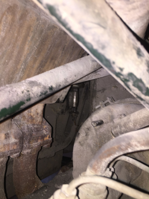

Thanks for the responses. I’ve had look at the wiring and nothing is obvious. The new oil pressure sensor was installed when the engine was out of the car and now I’m trying to figure out how to get a hand to it to check the terminals. Which is the easiest route to it? Do I take off the exhaust system?

#6 Re: Oil pressure gauge
Post by Nick V12 e type » Mon Sep 24, 2018 4:33 pm
Hello Simon,
I’ve just recently swooped my nonfunctional oil sender for a new SNG one. It seems on the earlier V12 the sender is very inaccessible, later it was moved to the top of the engine.
My method
Raise car, remove front wheel, remove the splash guard in front of the vacuum bottle. Not easy but you can now reach in to remove the wire from the sender.
I now used a crow foot to go on to the sender and an extension bar + a UJ + second extension bar to my ratchet drive. The extension bar threaded through between the exhaust down pipe and the engine frame allowing me to turn the ratchet below the sump.
All in all not easy but it worked for me.
Good luck
