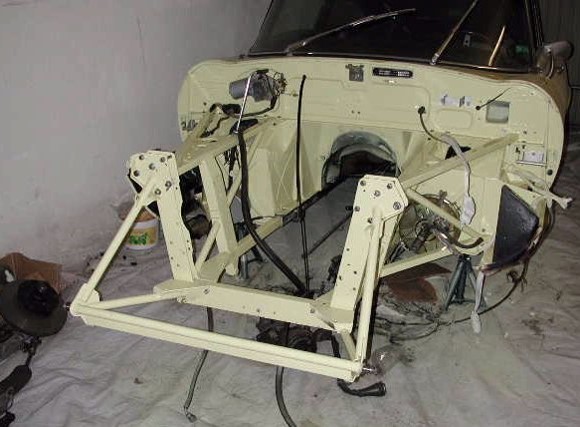

(C) on a stamped metal plate (about 2x8 inches) affixed to the fire wall just offset from the center-line of the car (see attached photo (**)). This plate will also display the numbers for the engine, transmission, and body.

(**) the 8" wide plate is visible just to the right of the bonnet safety latch. The VIN is stamped either above or below the opening for the pedal box, which is below and (in the photo) left of the heater box opening.
