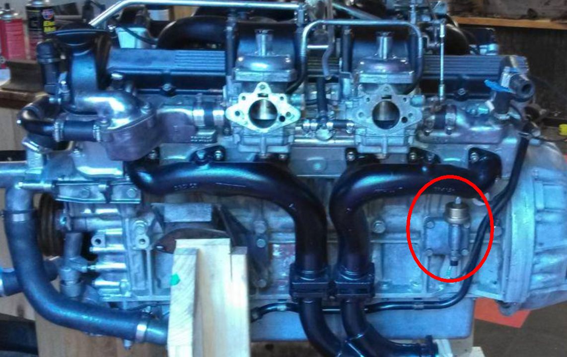

Bob.
Posts: 265
#13 Re: oil pressure woes
Post by Bob. » Sun Dec 23, 2018 2:25 pm
Hi John
Yours being a 1971 car, if it has the original engine, will have the oil pressure switch and pressure sender located low down on the LH side of the block near the rear of the engine in a pretty inacessible place. The tapping is into the main oil gallery. This area is close to the exhaust and is susceptible to any oil leaks from above eg cam cover or cam oil feed.
From 1972 the tapping was moved from the main oil gallery on the side of the engine to a point part way along the cam oil feed pipework, with the switch and sensor located on top of the engine behind the throttle pedestal where, unlike the earlier set up, it would be very easy to add a tee for a mechanical gauge.
Hope this helps

The reason I ask is, I bought it off a well known dealer that wasn’t bothered, and I phoned another well known dealer to ask if he would be concerned and he wasn’t, not in the slightest, anyway, it turns out I’ve got the oil pressure sender in Athens really awkward place..... how the hell do I get to the thing????
