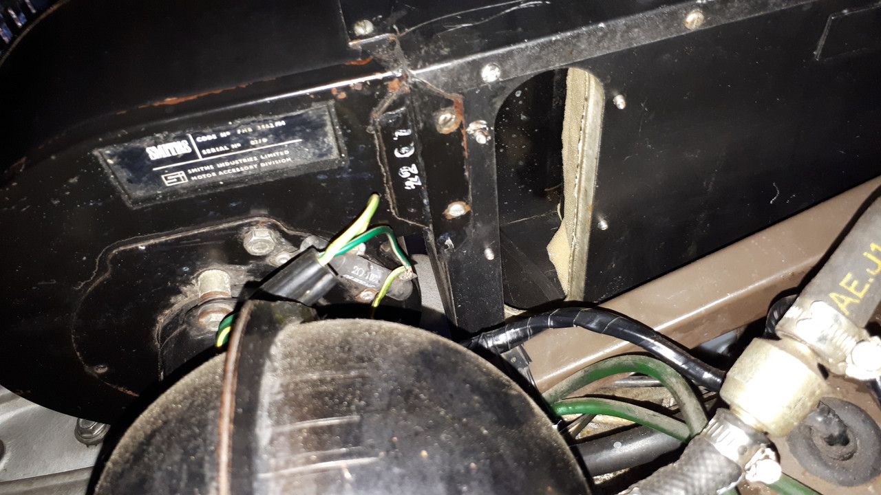

To test the cable to the water shut-off/reg valve (per JC): As explained. Operating the right control (Air hot-cold) needs to operate the valve full stroke.

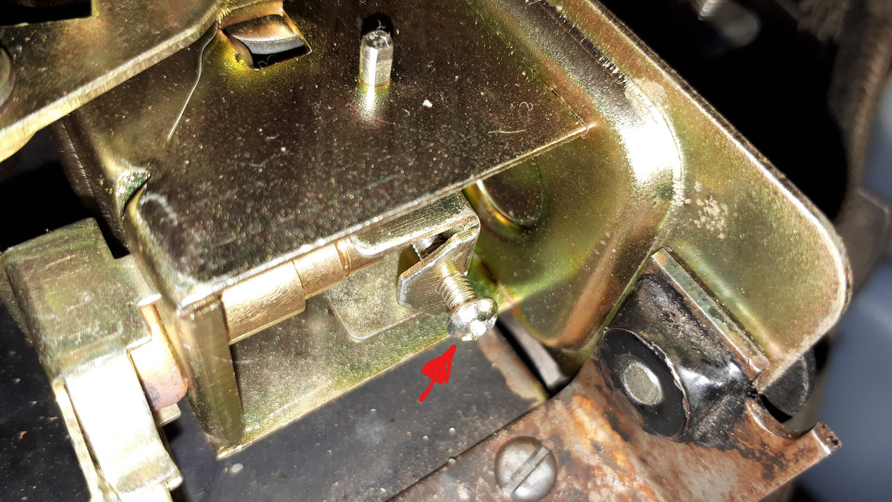

To test the valve (per Ole, Steve): Need only drain a couple of litres out of the radiator, so you don’t spill too much coolant everywhere, anti-freeze dries to a chalky residue. Remove the two hoses from the valve, use a thin screwdriver to loosen (prise) the hoses a bit from the pipes so you can wiggle them off without excessive force. Using a short, tight-fitting hose, blow thru the valve. When the valve lever is fully CCW blowing should be easiest. If not: Valve adjustment is by a small phillips screw protruding from the back of the valve mechanism (pic).
If this is screwed too far in there is no flow thru the valve, irrespective of the lever position. If the screw is removed there is always flow thru the valve. Adjust this screw until blowing is (virtually) impossible when the lever is fully CW and isn’t easiest until the lever is fully CCW. If it is still not possible to blow thru the valve: As Steve notes, there is an auto temp control mechanism, when air temp is hot the water flow is throttled. If this mechanism is jammed (in the hot air position) u might not be able to blow easily thru the valve, even when the valve lever is fully CCW. Get a new valve.
To test the heater matrix (per Stuart, Ole): If convection makes hose temp inconclusive, alternative procedure is to remove the hoses to the matrix and try blowing thru. If cannot blow easily yr up for a new matrix.
To test the Air on/off control (per Ole): The left control (Air on-off) should flick the flap fully open or closed, no intermediate position. If the oblong vent thru the bottom of the box is open (u can stick yr hand in) it means the flap is up (vertical), air from the heater fan is being diverted into the engine bay, there can be almost no flow of heated air from the matrix into the cabin.
For hot air into the cabin this bottom vent needs to be closed by the (horizontal) flap .
Air flow over the matrix (fins) can also be blocked by build-up of dust, pollen etc. that clogs the fins. Is hard to detect this, Dismantle box and clean.
