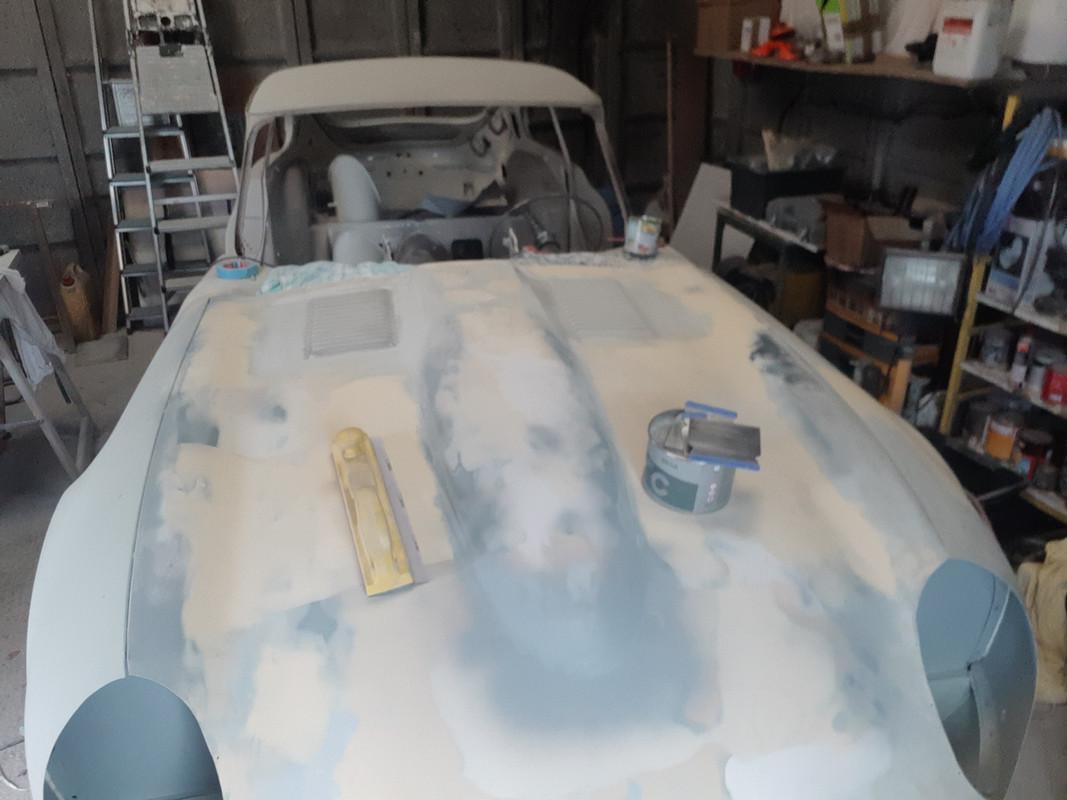

A very interesting result I schould share when I will finish my own s3.
I do use a 2.88, a getrag 5 speed and 205 x 70 x 15 tires.
The speedo I have is a 6332/05 which is reputed to be used with a 3.07 diff. Dont know what all this will bring on the speed measure.....
A picture from the car with a few things to do :-)
What ratio is 5th on the Getrag?
Oi!! Just a FEW things....
