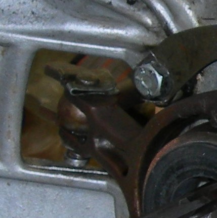

Post by Ole-xke1974 » Thu Jan 10, 2019 3:15 am
I found a picture of mine from when I did the Auto to manual conversion. Once you have the locking "thingie" off at the top, you should be able to push, drive it out. Heat and penetrating oil are your friends.

Post by Leekade » Thu Jan 10, 2019 10:46 am
Thanks chaps for your words, and for the photograph which captures the offending pin perfectly! I guess I'm just going to have to stock up on gas for my blow-torch and oil... At the moment, it's not breaking the bank and providing hours of fun on the internet researching parts and information, not to mention scraped knuckles :lol: . Cheers, Adrian
