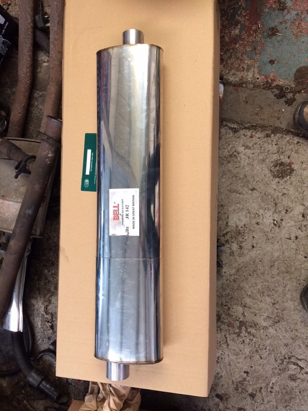

I bought 2 of these (see photo)from SNG and tried to fit them yesterday to my 1973 Series 3. They will only fit on one way due to the positioning of the inlet/outlet on the silencer. it seems that the inlet and outlet parts on the silencer have been fitted the wrong way around or the exhaust pipes are incorrect on my car. Does anyone know what outside diameter of the ends of the silencer should be? I have the front measured at 51mm O/D and the rear at 54mm O/D. They would fit my exhaust perfectly if i reversed the silencer but for reasons explained its not possible. Is this a manufacturing fault otr wrong connecting pipes on the car? Any help greatly appreciated.

Hi Bernie -Limited access but just had a quick check under my car which has a st st system of unknown origin fitted so no guarantee that everything is to original dimensions.
OD of inlet pipes at entry to the silencers is 2.0" (ie ID of silencer inlet) and distance between centres of the two silencer inletss 9 1/2". OD of outlet pipes at silencer exit points is 1 7/8" (ie ID of silencer outlet) and distance between centres of approx 6".

The larger pipe is the inlet (front) which allows the link pipe to slot inside the silencer.
The smaller pipe (rear) should have the outside dia the same as the inside dia of the front assuming they have used the same tube,one end is expanded.

The front pipes have an outside diameter of 51mm and fit into the silencer without any effort.
I think you can use the silencers only with the Bell pipes.

Ive just had another look at the exhaust system and it looks old enough to be original. Does anyone happen to know what the outside diameter of original pipes on the Series 3 exhaust system were or where I could find this info? ie the ones that go into the front of the silencers and also the outside diameter of the ones that go out of the back of the silencers?

The OD of the pipe before the silencer is 2 inches and the OD of the pipe after the silencer is 1 3/4 inches. These are the exhaust pipe outside diameters, not the silencer spigots.

Thats interesting Allen was it the same problem? When we position them in line with the existing inlet and outlet pipes they wont sit together as they are too close.

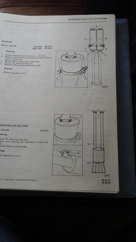

Hi Bernie...does this help...from the service manual....there are also other detailed drawings in there....Steve
