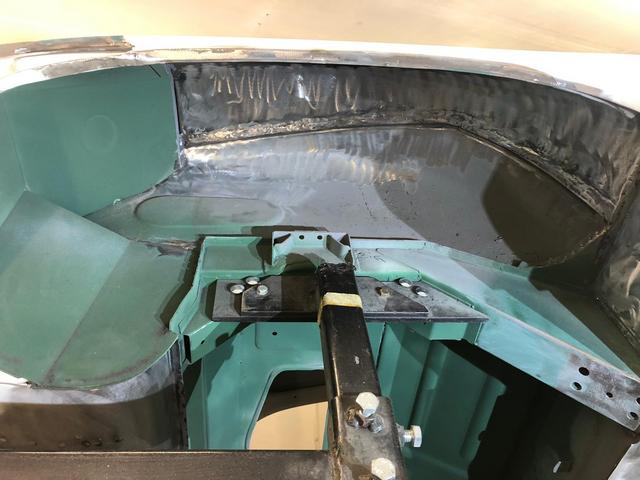

I have managed to get hold of a rotisserie to enable me to work on my S3. I am looking to make some brackets to get the rotisserie to fit my car but need to know if any of you good folks have any pictures of where to mount it to the back end? I have had a few suggestions, but believe a picture tells a thousand words.

Thanks for the link. However I already have the rotisserie. I am just having difficulty seeing where to mount it onto the rear end of the car.

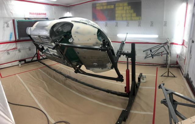

Post by mach2andy » Wed Mar 13, 2019 4:08 pm
Hi Davie
I'm assuming the rear end of an S3 is not a lot different to an S2? If this is the case then these pics of the rear rotisserie mounting on my S2 might help?
ATB
Andy

Post by Davie jay » Wed Mar 13, 2019 6:34 pm
Hi Andy,
Those pics are really helpful.
Thanks very much.
