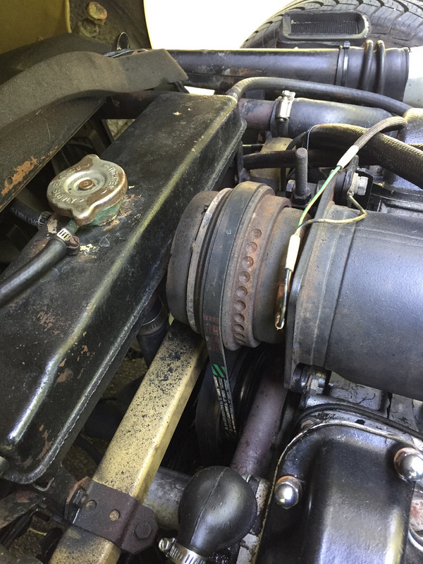

Turned on my AC today, and you can see in the pictures bits of the rubber were wearing out. Any idea what is causing this and what is the fix? Sandy

Hi Sandy...is it rubbing on the frame.....engine mountings sagged?.....Steve

You have a pulley alignment problem.

Thank you. Is there a simple way to diagnose if the engine mount is sagging or the pulley is out of alignment?

Hi Sandy......if mounts are sagging then things will start to touch where the shouldnt like if that pulley is touching front frame.....if pulleys arnt aligned the belts wont run straight...its just a visual inspection..Steve

As all the pulleys are mounted in one way or another to the engine I can't see it being engine mounts. The debris on the frame comes from the top pulley rubbing against one side of the belt.

Have you observed the engine and the compressor when it is running? Looks to me as if the compressor has an issue and the belt is having trouble turning it and the belt is slipping on the compressor pulley and the belt is shedding rubber accordingly.
I would remove the belt and check the movement of the compressor with the clutch engaged and disengaged - maybe there is a tight/failing bearing in the compressor.

The very front part of the compressor is rubber (possibly a damper) in the 2nd photo you can see it breaking up..also the poster says the rubber is wearing out.....it must be rubbing on something.....Steve

Could be your compressor starting to seize up, causing the belt to slip. Happened to my Chevy bus. Made one hell of a noise as well.
If this is a new phenomenon, what would cause a sudden miss-alignment of the pulleys ?

Thank you...you are right. the compressor is not running right. I have a video, and i am having trouble uploading to this. Is there a way i can upload?

Apologize for not getting back. The issue was the AC compressor needs to be replaced
