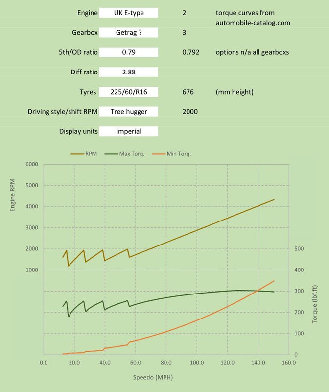

I have made me a calculator to address the perennial, which gearbox and diff question, this also predicts true rpm versus mph. Some examples:

Here is the maths:
Engine speed, ES = 2700 rpm
Gearbox ratio, GB = 1 (4th gear)
Diff (final drive) ratio, FD = 2.88
Wheel speed, WS = ES / GB / FD = 937.5 rpm
Tyre perimeter (distance travelled per wheel rev) can be calculated from the designation on the tyre, e.g. for 215/70R15:
Nominal Tyre height, NTH = 15 inches + 215 mm x 70% x 2 = 682 mm
Tyre perimeter, TP = PI * NTH = 2.143 m
Distance traveled per time = TP x WS = 120.52 kph = 74.9 mph
Doesn’t include corners and wheelslip, which would cause actual distance traveled to be less than calculated. Still, yr GPS 69 mph is a lot less than 75 mph.
Reason for my pedantics, I’m trying to justify decisions already made when the benefits are marginal. I have an LdN overdrive reco’d ready to install, diff is currently 3.54. I have updated my calculator to display comparisons, some observations:
2.88 diff without OD versus 3.54 diff with OD: Cruising speed/rpm is the same. Below ~30 mph the 3.54 has 20% more torque available so could accelerate harder except for the extra gear change. It could also crawl slower. So maybe better for < 1% of the time (drag-racing and when stuck in traffic jams) but very annoying for the remaining 99% of the time.
Adding OD to a 2.88 diff: Cruising at 70 mph the OD car could rev 500 rpm slower, 2000 rpm instead of 2500 rpm. I suspect higher throttling losses might limit any mpg benefit. At this operation the OD car would have relatively weak acceleration (30% less torque available), corrected by flicking the switch; imo this is the big advantage of an LdA overdrive compared to a true 5 speed, you don’t have to change down to get back on song.
