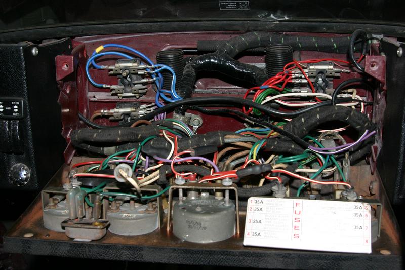

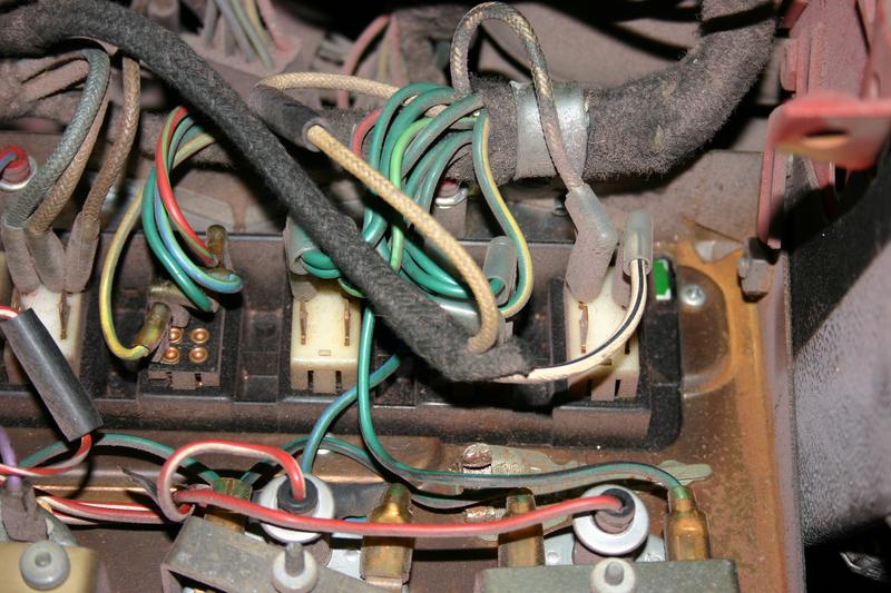

Here's a few pictures that might help on the RHS of the frame.
I have uploaded the 3 pictures but not sure if I have done it correctly
PM me if not showing
Colin

Hello Colin, thank you to share these very interesting pictures.
Exactly what I m looking for.

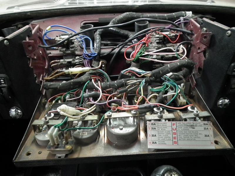

#5 Re: Help for the wiring loom
Post by ManniB » Tue Dec 24, 2019 8:19 am
Hope this helps, Manfred

Post by MLBS3V12 » Wed Dec 25, 2019 9:26 am
Vielen Dank Manfred,
das hilft sehr :santa:
:thankyouyellow:

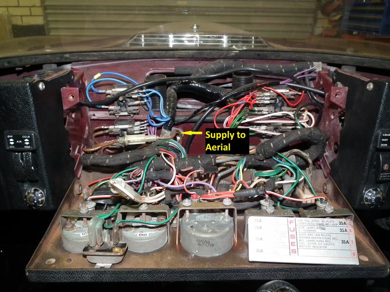

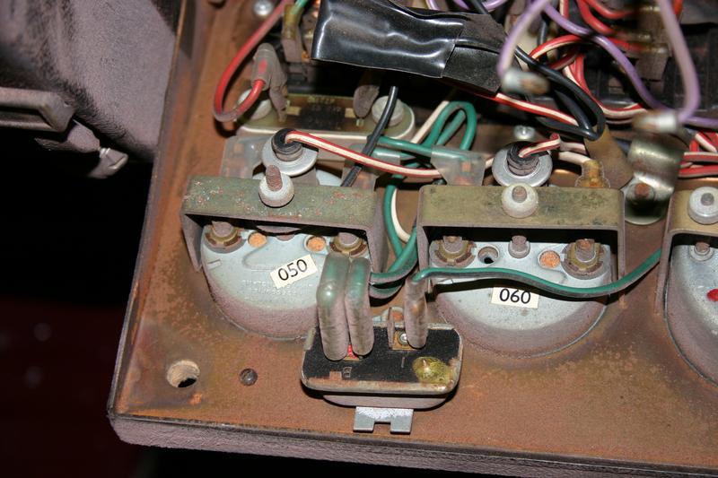

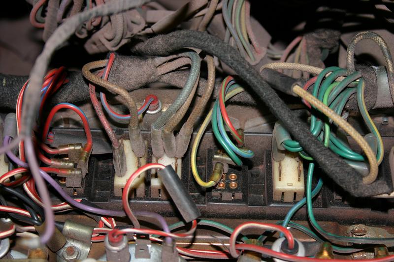

Post by vee12eman » Wed Dec 25, 2019 12:08 pm
Hi Michel,
Is this any help? (Don’t forget of course, that my car is RHD!)
Some before and after shots. I have some more if you need them, some for the radio too, I think I had to make my own extensions for that in order to link the power aerial and a modern (old style) radio with mp3

Post by vee12eman » Wed Dec 25, 2019 12:19 pm
Hi Michel,
Here are the radio connections:
And one more of the final fit, prior to fitting the dash top:
Happy Christmas!

Post by MLBS3V12 » Mon Apr 20, 2020 4:36 pm
Hello Simon,
a last question ( at least for no ) on a green wire on your picture
I dont know what it is for.
