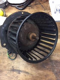

Has anybody found a clever, non damaging way to separate the fan from the heater fan motor?

When I did mine, I soaked the spindle/bush in penetrating oil twice a day for four days and then applied gentle heat to the bush before prising it off.
