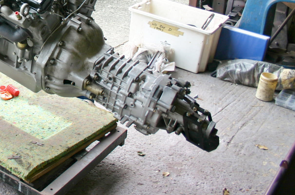

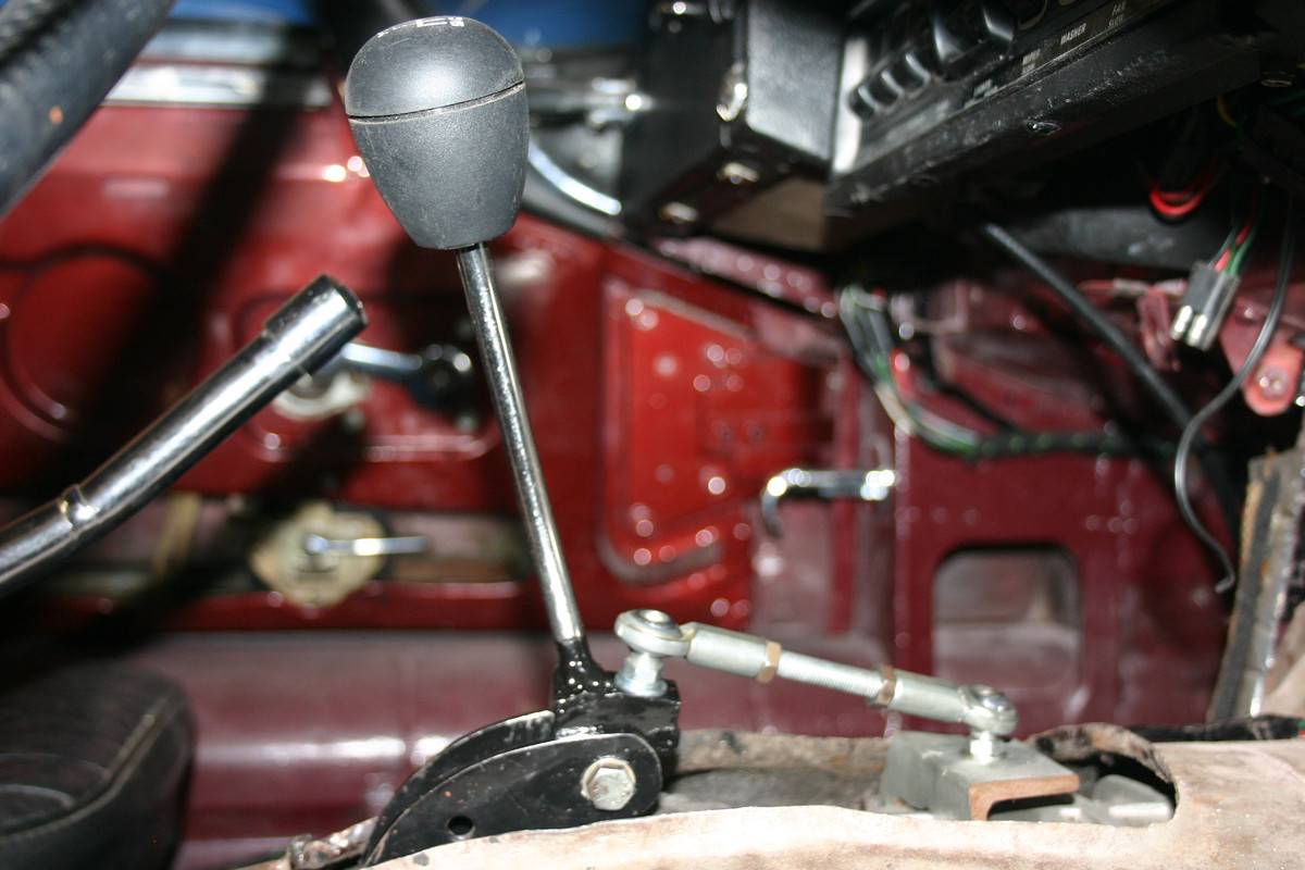

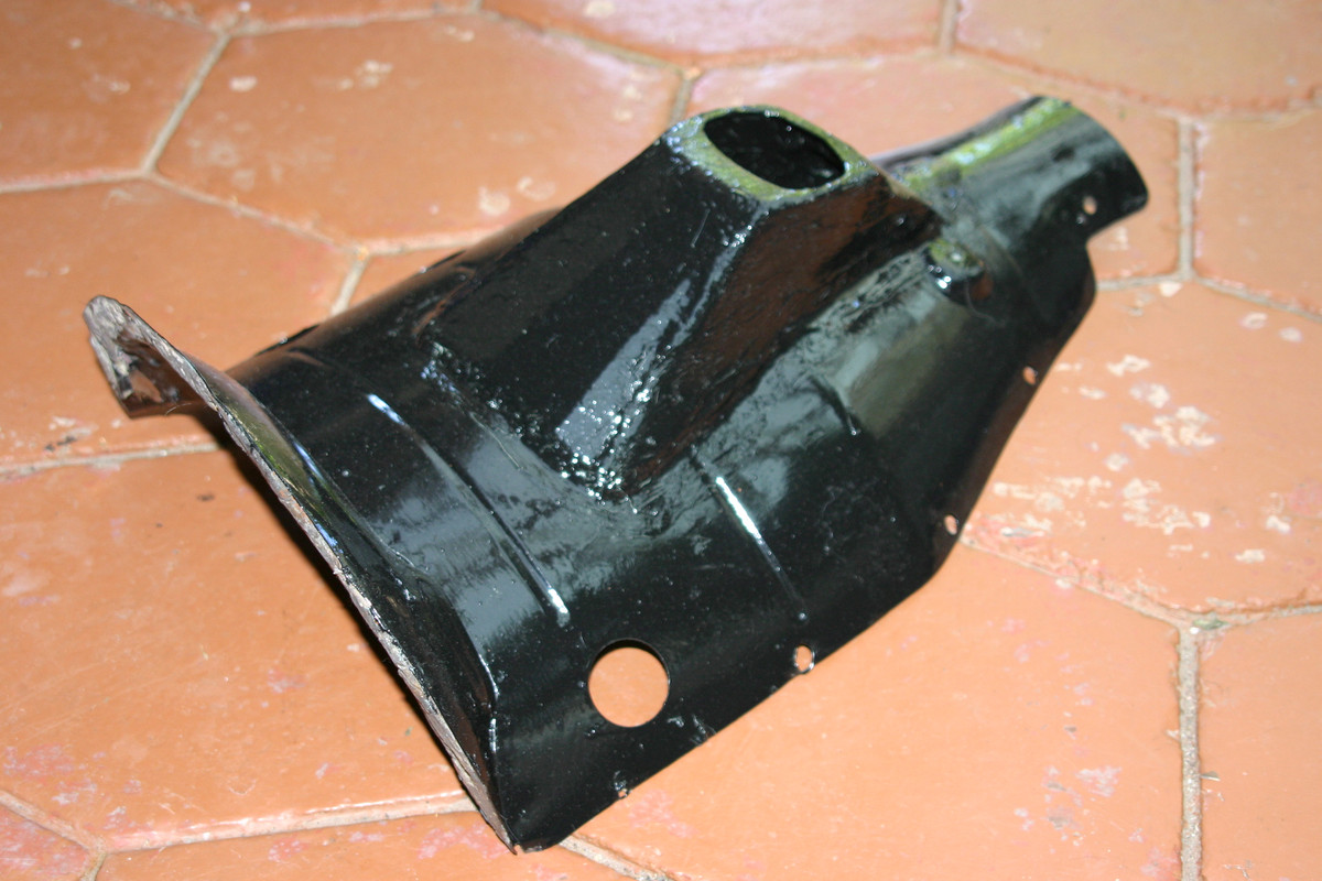

Some photos:
From the eBay advert:
This is from the eBay advert but is actually my car:
Tunnel cover:
On the crane when fitting to the car:
Home made linkage:

Home made linkage:

That looks the same as my bellhousing. The photo of the clutch fork is very helpful.
