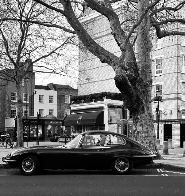

What would she be like, will she behave, does she look like her pictures, is there going to be a spark, is she going all the way, is she going to be high maintenance?
Truthfully, she looks better in the photos of course, it was a tense first date, but day 2 is already looking better.
The drive from Bucks to London, as per previous post, all the gauges except Speedo died (unexpected benefit, I'm getting better at spelling the word gauges now). That would seem to be an earth issue that has magically rectified itself for the moment. :?:
Then all the gauges came back except for the temp. Got me worried sitting in gridlocked traffic coming over Albert Bridge. Sure enough right at the lights before the busy junction the engine starts to die...I JUST about made it across the crossroads and coasted to the embankment pavement. I'm paranoid it's overheating. After procurement of large pack of Evian (Nothing but the best for this chick) just about to fill the water and noticed vacuum hose from carb is detached, reminds of of Daniel Craig in Casino Royale trying to use his defibrillator.. amazing how such a small cheap part stops this massive beating heart...we made it home in another 5 minutes.
Found the temp sender, contact was covered in corrosion. Sorted.
After unloading the spares, took my wife and the new mistress to the pub and wound down, enjoyed watching the public fall over themselves trying to get pictures and nearly getting run over by the No. 11 in the process.

All in all, could be worse and in summary I think she's a keeper.
My oh my was there plenty of power under that pedal... 4 speed manual box, doing 60 the rev counter is barely off zero.. is that correct? How far are you going when you hit that redline?!
Blip pedal, hit (ahem) 70 in no time. Didn't want to push her until we've gotten to know eachother a little better.
She's pretty.
