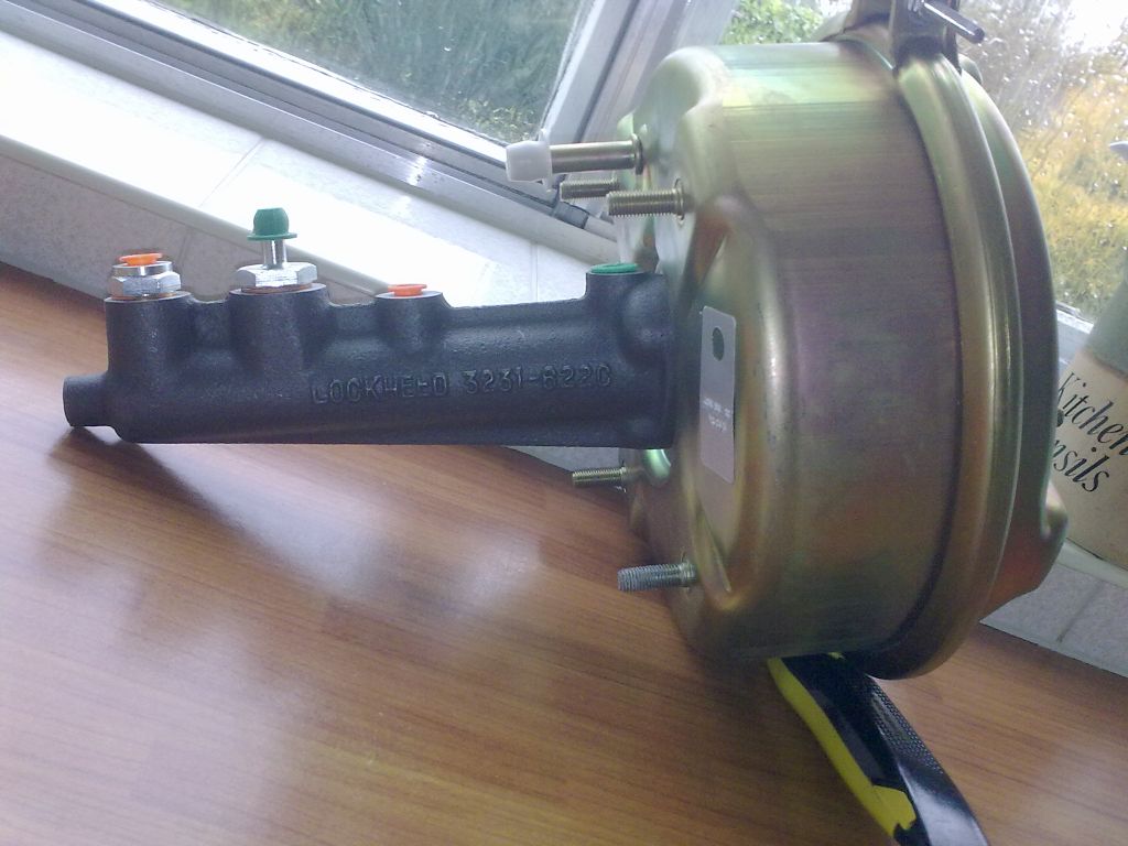

I tried to get mine done professionally, by ABS (national brake engineers in Oz). They dredged up a retired old ex employee especially. He started very keen and excited but cooled off when he learned what was involved in removing the servo, and bleeding the inboard rear brakes, etc. In the end he walked off and I had to collect my car, repair it myself. Took a lot longer than 4.5 hrs. I found it was cheaper to renew rather than refurbish (corroded cylinders). The servo has mounting studs front and back, on e-types the front studs are not used. New servo (from SNGB) the front mounting studs are longer, makes installation impossible. If you cut a couple of cm off them it is easy.
#7 Re: Series 3 Brake Servo Replacement⅚
Interesting, I fitted a new "Lockheed" servo from SNGB last year and had no problem with the length of the front studs fouling during fitting - just the usual jizsaw puzzle of threading it through the framework. I found it easiest to remove the heater for access. No need to drain the system just siphon enough coolant out to lower the water level enough.
