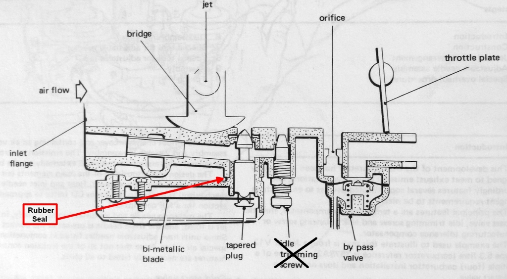

The temperature compensator is an emission control device intended to compensate for variations in fuel air ratio caused by heat transfer from the engine to the carb body, eg when car is stationary. It is intended to be fully closed up until 45°C (approx) and fully open by 60°C.

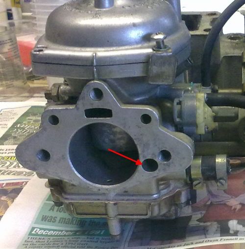

If you want to block it off for trial purposes it is not necessary to do anything other than remove the air cleaner and block the passage to it with a piece of tape, although it is essential that the rubber seal between the compensator and the carb body is intact to avoid air entering here.
If you want them to work as intended, all four should open at the same temperature and you can have hours of fun setting them up using a kettle, two bowls of water and two thermometers. If they have been closed down by tightening the nuts fully, the bimetallic strips will have been distorted and will need careful bending before correct operation can be achieved again. (it doesn't really take hours)
