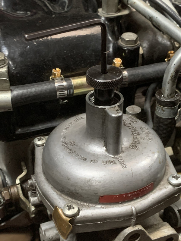

Adjusting the needle is through the dash pot lid with a special tool, a long Allen Key with a top hat section insert. The insert has a pin which engages in the slot at the top of the piston, to stop it rotating when you adjust, which runs the risk of tearing the diaphragm. The Allen Key goes through and into a nut at the bottom of the dash pot reservoir and rotating it causes the needle to rise (strengthening the mixture) or lower ( weakening it). These nuts have seals around them to keep the damper fluid contained, but most are now leaking so should be replaced. It’s often overlooked or even deliberately ignored as replacement automatically requires tuning.
You have to remove the grub screw from the piston. When refitted, this engages in a slot at the top of the needle and should allow limited up/down movement under the influence of the adjustments using the aforementioned nut. Remove the needle and the brass cylindrical base, they often stick so you have to free them sometimes, gently of course. The nut and retaining clip can be seen below, you have to gently tap them out with a long punch, don’t lose the retaining clip (looks like a spring washer). Seals available from Burlen Fuel Systems amongst others and often come complete with new nuts. Seals are around the outside of the nut.

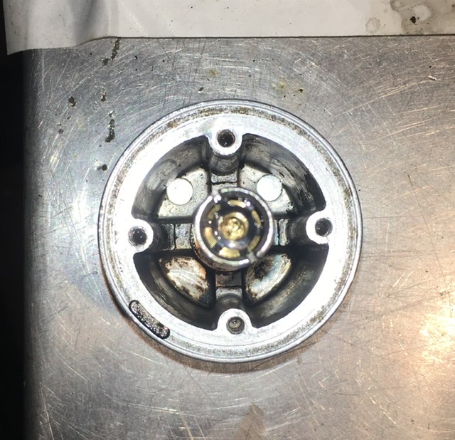

Jet outer land 2.5±0.3mm below the bridge face (orifice is 0.5mm lower). Data was verbal from Burlen Fuel Systems Ltd in Jan 2017 after they had consulted their drawings. It worked for me with factory settings of 16.5±0.5mm for float levels and 1.5psi fuel pressure. (sorry for mixing units)

thanks all. I will set them at 2.5mm below the bridge to the outer ring. Interesting to see that I am yet another Nigel with a Series 3 ...

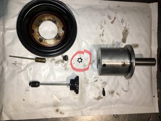

Related to this topic, can anyone confirm a source for the spring clip circled in Simons photo. I want to be able to replace the rubber o rings on the adjuster without having to buy kits from Burlen.
Apologies Simon for using your photo, I hope OK.

I found Burlen quite happy to provide individual items, give them a ring.

No worries in using the photo, they were added to help. I re-used the spring clips with no issues so unless you have lost or damaged them, you should be fine. If they are loose, then very carefully tap them a little flatter with a light tap from a hammer before re-using. Burlen should be fine to supply individual items.

Thanks Simon, good to know you can reuse them

Nigel ( I'm yet another Series 3 Nigel owner), I have been having problems setting the idle on my car, hence all my posts. I eventually measured the depth of the jets (which I had replaced when rebuilding my car). Mine are set a bit too high at .070 inch 1.5mm below the bridge as measured to the outer land of the jet (not to the jet itself). My car is running fine but i am on the limit of the adjusting screw (fully clockwise) and I would like to enrich further just to see what the difference would be. I recall reading on another post that the adjustment screw can add .030 inch so this sort of fits with the correct depth being 2.5mm .100 inch as you suggest.
I was looking for a way to press these to the 2.5mm .100 inch insitu. I dont like the idea of resorting to a punch (suitably limited) and hammer again (this was how I set them originally). I am now resigned to leaving this until next winter and enjoying my car this summer. FWIW.

Clockwise means the needle rises, the nut stays still but the needle is drawn upwards as the nut (effectively) tries to screw itself down the needle carrier. As the needle is tapered, this enriches the mixture, whereas anti clockwise pushes the needle down and weakens the mixture. Hope that’s clear.
