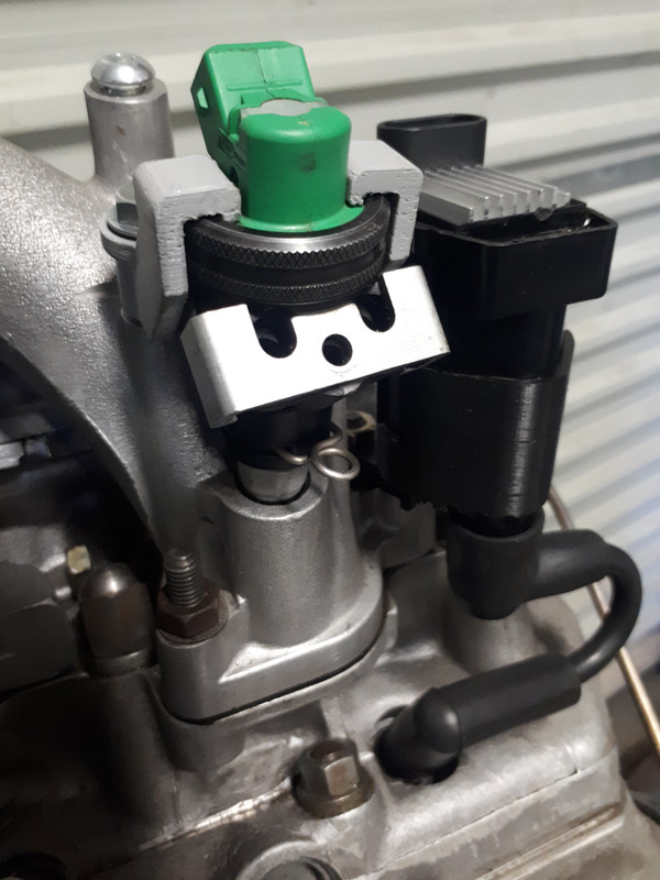

Carb vs efi? I think this discussion is comparing carbs with legacy efi? Surely, no reason a modern ecu couldn’t be programmed to do at least anything that carbs can do, if that’s what u want?
I’m hoping that, with modern efi, controlled by latest tech 4D fully sequential adaptive ecu, efi will outperform carbs across the board and be monstrously more efficient to boot. We shall see.
I am complicating things by trying to convert to dedicated LPG liquid-phase injection at the same time, i.e. not dual fuel, no petrol at all. It is proving very hard, the industry (Vialle, Icom) is very protective of their “tech.” e.g.:
Me: Hello, pls can you advise, what is the capacity of a Vialle PTS-70 pump?
Vialle: The flowrate etc. are details that are not given by us, they are never shared outside our organization. I hope that this is the answer you are looking for and it will help you with the system.
Also complicating things, I’m challenging myself to make it a “bolt-on” upgrade that will work on any efi V12. The secret is liquid (not gas) injection, at least 10% more power that with petrol, 50% reduction in fuel costs and Euro 5 or better emissions. Can’t do that with carbs. So imo, if you are not trying to be utterly original, evolve to efi.
Here is my latest prototyping effort, mounting the LPG injectors:
