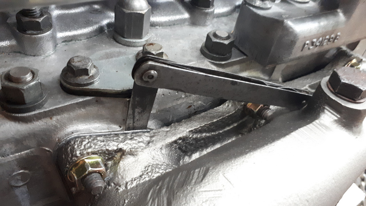

After bolting mine on i can push a feeler gauge into one of the ports, i.e.:
I guess this means it will leak. Has anyone had lasting success with double gaskets and/or plenty of putty?

#13 Re: Exhaust manifold seal rings
I would rather skim those manifolds, taking into consideration that the two ports must still align after being mounted to the head.
