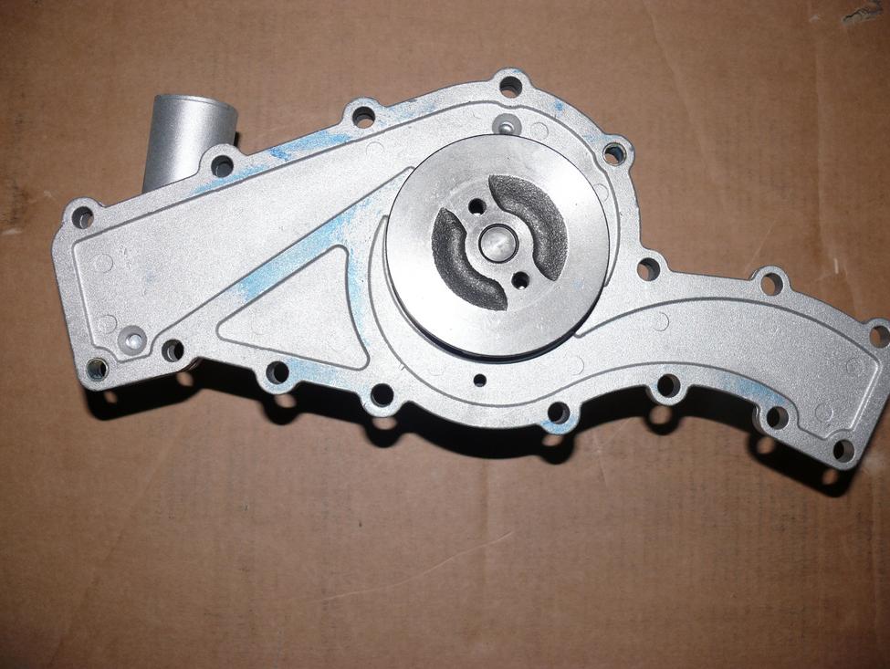

The surfaces are far from being perfectly flat. The face of the Water Pump Body where it interfaces with the Sandwich Plate (the area of your concern) is the only face that's machined; neither side of the Sandwich Plate is machined. Original equipment water pumps also had no post casting machining of either face of the Sandwich Plate, but these were Die Cast and were sufficiently flat and parallel to seal. Sand casting, which is what your new water pump is, is a totally different kettle of fish.
The following picture shows the transfer of Marking Blue from a Surface Plate I made (surface ground plate with a hole bored in it to clear the impeller) to check the flatness of the surface that interfaces with the engine. Although very small deviations from flatness would indicate the same, I was able to get up to 0.4mm feeler gauges between the surface plate and Sandwich Plate in the areas where no Marking Blue was transferred.
I reported the matter to the supplier and received the reply that it is OK.
Having an informed opinion as to the result, just for giggles, I mounted the water pump dry on an engine I had out of a car, filled the water galleries with water and applied a pressure of circa 7psi to the system; it leaked like a sieve from both sides of the Sandwich Plate. The same test was applied using increasing amounts of Permatex Sealant with the leak being stopped when the amount of sealant was way past what I would trust in the medium to long term.
I stripped the Water Pump and machined both sides of the Sandwich Plate. The same test applied with clean, dry gaskets resulted in no leaks.

I operate an E Type Restoration business in Victoria, Australia, part of which is a well equipped CNC machine shop and I have, or have made, every tool you can imagine for dismantling and reassembling component parts of the E Type. Accordingly, its not that hard for me.
You will note the two holes in the impeller, shown in the picture attached to my previous email; these are threaded hole for the purpose of removing the impeller. Don't use a typical pulley puller, the type that grips the OD of the part. The chances of breaking the impeller using such a puller are high.
You need a plate drilled with two holes clearance on 5/16", the centre distance the same as the tapped holes in the impeller. Another hole is drilled and tapped at the centre point between the two holes drilled in the plate; mine is drilled and tapped 1/2" UNF. In operation, the plate is secured to the face of the impeller via the two drilled holes. A bolt applied to the centre threaded hole will pull the impeller from the shaft.
I take the precaution of warming the impeller to give the part every chance of moving without damage. Cast Iron is more likely to break when stone motherless cold than when warm.
When pressing the impeller onto the shaft, ensure that the opposite end of the shaft is supported and that you're not transmitting load to the body of the bearing assembly and hence the bearings.
