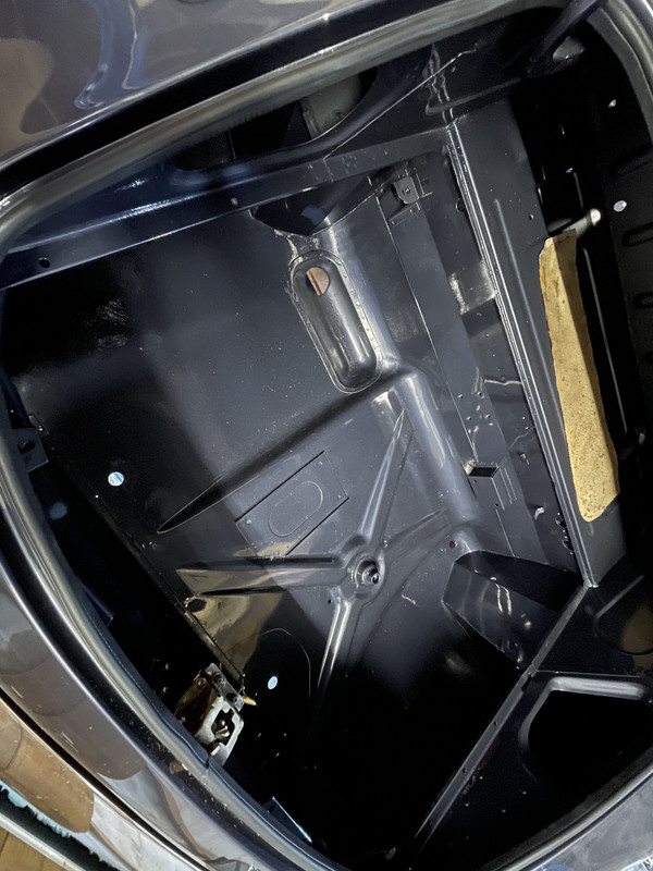

Hi all, does anyone have a photo of the area under the spare wheel of an unrestored series 3?
My restoration has got as far as a painted but bare shell and I’m starting the build up by replacing the sound and vibration deadening pads (hardura) starting in the boot so I can return the fuel tank and the rest of the fuel system bits.
I want to try and make it look as authentic as I can though I’m not seeking to build a concours trailer queen.

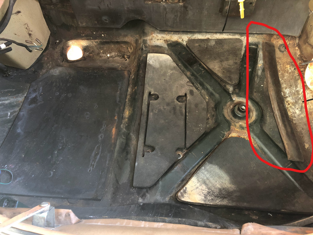

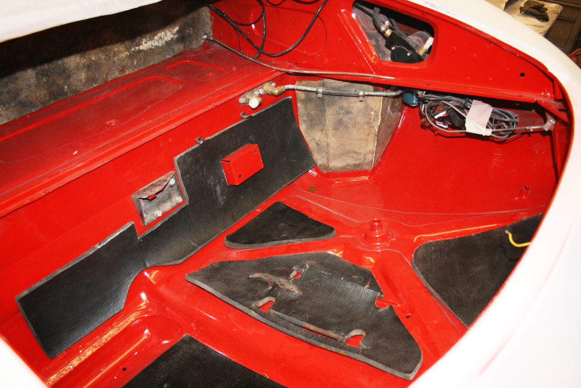

Ah that’s interesting Colin as you have a bit of sound deadening to the right of the spare wheel thread, which I will now try and replicate.I’m using a sort of hemp with a plastic bonded top surface which is slightly like the original material seen in both your photos which I’m hearing is unavailable, at least in the UK.

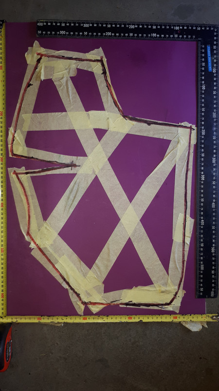

Part # BD.38073 according to my parts catalog. Maybe sometimes not refitted, I can think of pro's and cons. Imo would be one of the most effective sound deadening panels in the boot, for preventing reverberation and for muting the fuel pump. However it is under the fuel pump and filter, any fuel leaks/spills that soak into this hardura could cause a smell that might be difficult to remove.
Here is flat pattern, inside the red line, should scale ok ...

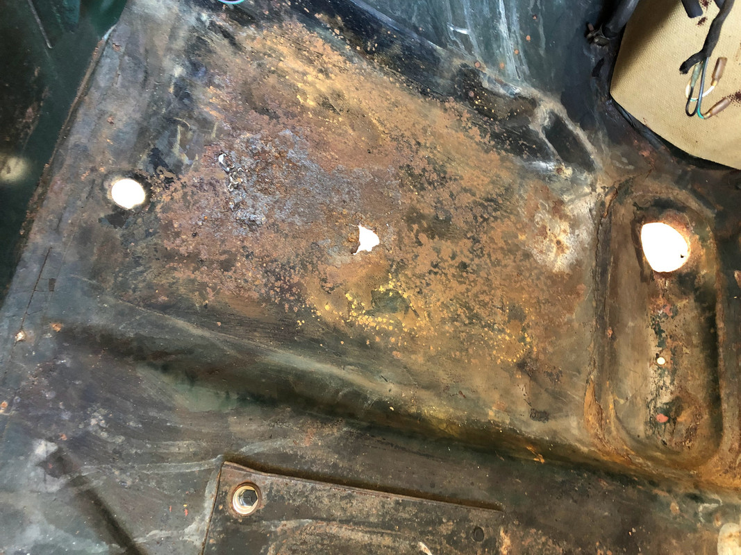

The Hardura as shown in Colin's pic is supposed to be there - However early in my ownership I removed it as any water finding its way into the boot area drains out there and with the Hardura in place moisture accumulates under it and rusts the floor.

Ain't that the truth...under the tank.AussieEtype wrote: ↑Fri Dec 03, 2021 12:58 amThe Hardura as shown in Colin's pic is supposed to be there - However early in my ownership I removed it as any water finding its way into the boot area drains out there and with the Hardura in place moisture accumulates under it and rusts the floor.

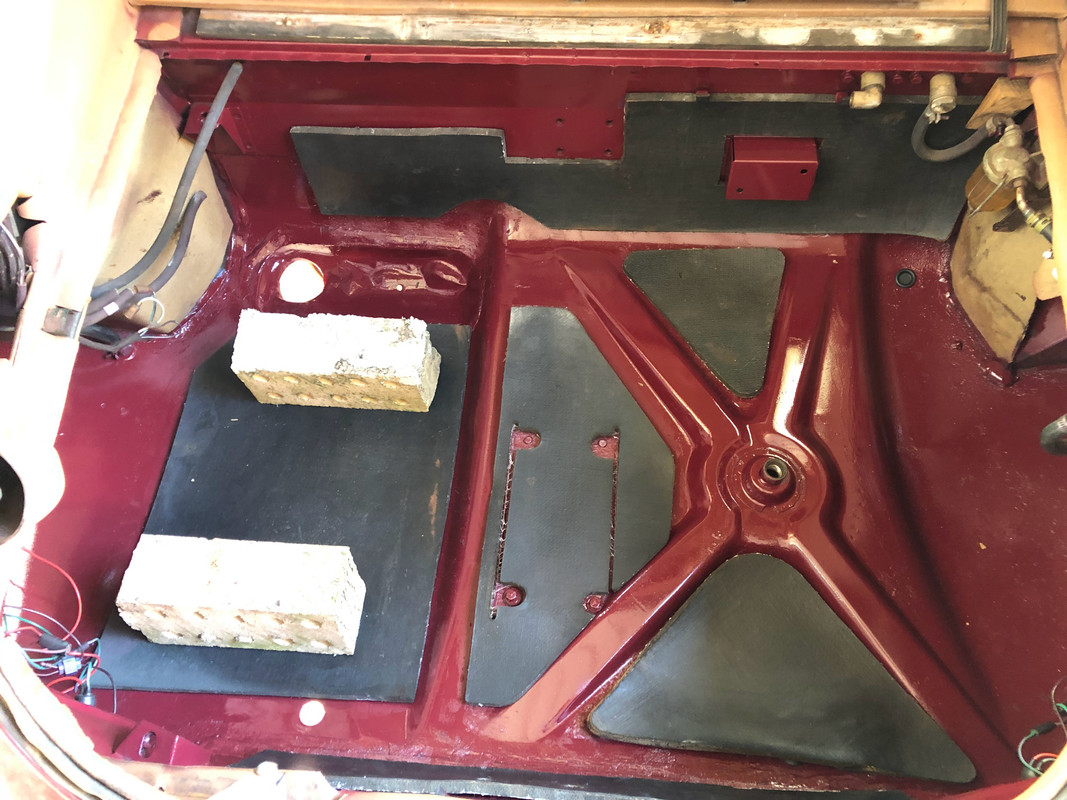

Always a risk when hardura is glued? At one stage I did a brutal deodorizing, which resulted in the corners of some hardura becoming unstuck, curling up a bit. When I restuck them I noticed this subject piece (BD38073) had a small cavity under, easy to do I guess as it is a flat piece being stuck to a complex surface. Fortunately no corrosion. Restuck it with weights and clamps to hold it until the glue had set.

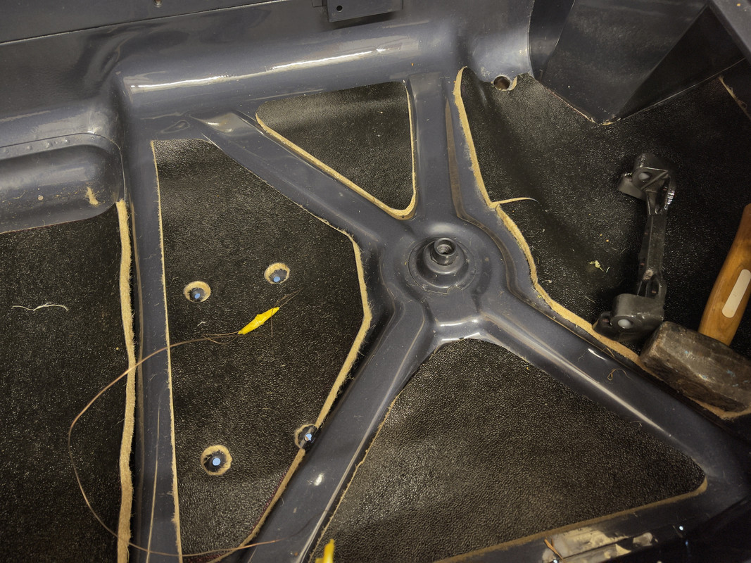

Thanks guys my hardura pads were in a real mess, not helped by me forcibly ripping them off the car before it was media blasted. So I have struggled to create new panels but using all your photos I’ve managed to cut guess it and cut new ones from a felt/hessian sort of material with a plastic top surface (cos I couldn’t get from anyone in UK the original hardura).
Trouble is, any water getting in the boot is going to soak up into that worse than hardura so going to be very important to ensure no leaks.
On that there is a fuel tank pad BD37908 which I think goes round the drain but which was not fitted to my car. Don’t know whether this is a good idea or bad- it might stop water kicked up from the road entering the boot and getting stuck causing rust but equally it would stop water draining out and the area under the tank being ventilated.
Photo shows job half way through after today.
Bob

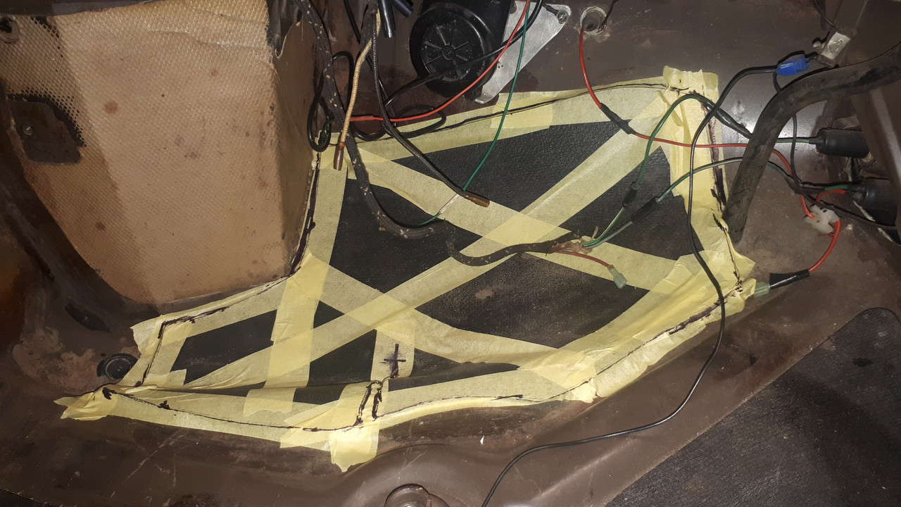

Technique used was like ColinL. Only right ones stuck down so far
