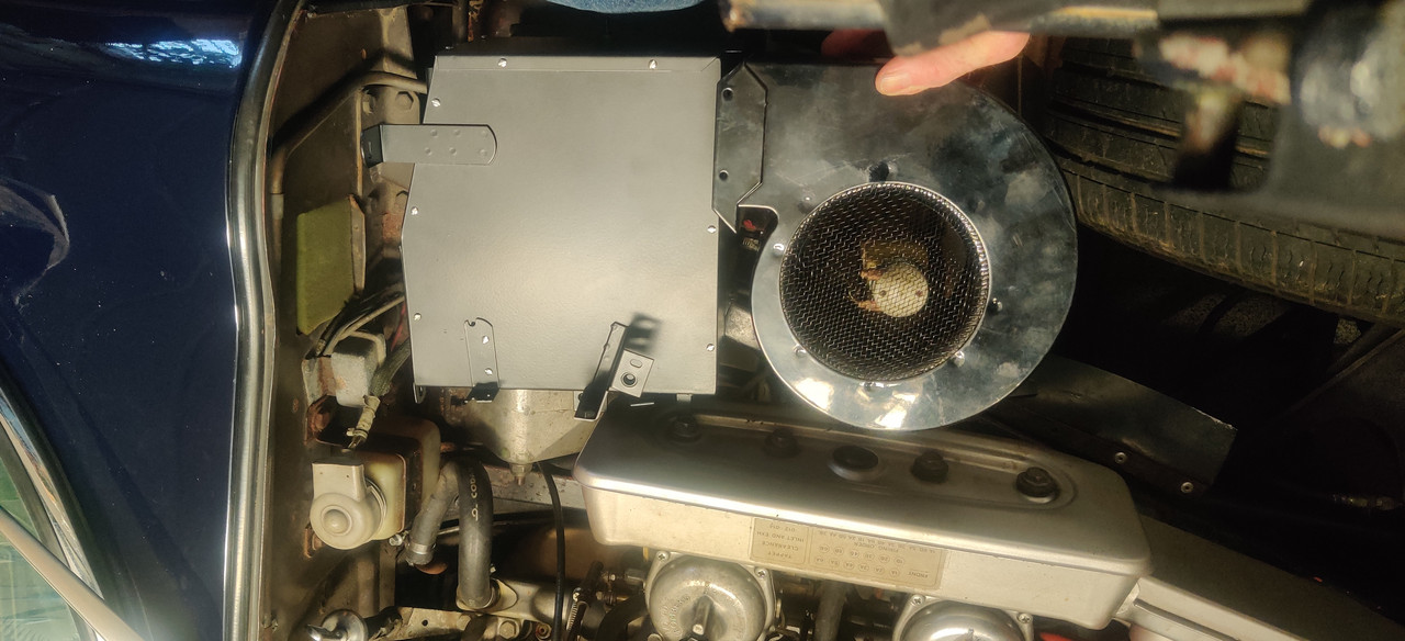

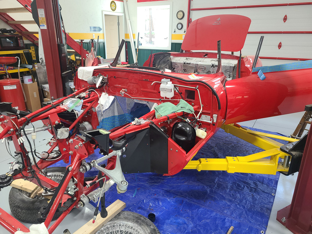

Am collecting all the various parts needed to reinstall the heater and fresh air ventilation systems on my 71 (ex US) S3. PO for some reason removed it in its entirety from engine side of bulkhead - controls and levers within dash/cockpit seem to be still there. However (see photos) where the heater mounts to the bulkhead a large relay has been bolted into what I assume is one of the 4 mounting holes. What is this relay for and where should it be relocated to (does it matter)? I assume once relay is out of the way I can simply bolt (x4) the heater box to the bulkhead - brake servo vacuum pipe crosses this area as well so cannot be 100% sure will allow for this until actually fit.
Thanks in advance. (As you can see a wad of green foam has been pushed into the hole in the bulkhead IOT block air flow in absence of heater. Quite a bodge!

Gordon,
I can only speak for LHD E Type Series 3:

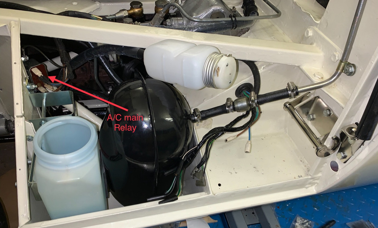

There is only one relay on the left hand side near the bulkhead, this is the air conditioning main relay. In its original condition it is bolted to the left mudshield, next to the brake fluid reservoir for the rear brakes (see extract from repair manual and photo).
The contacting of this relay is as follows: C1 blue cable, C2 blue-brown cable, W2 white cable, W1 earth black cable.

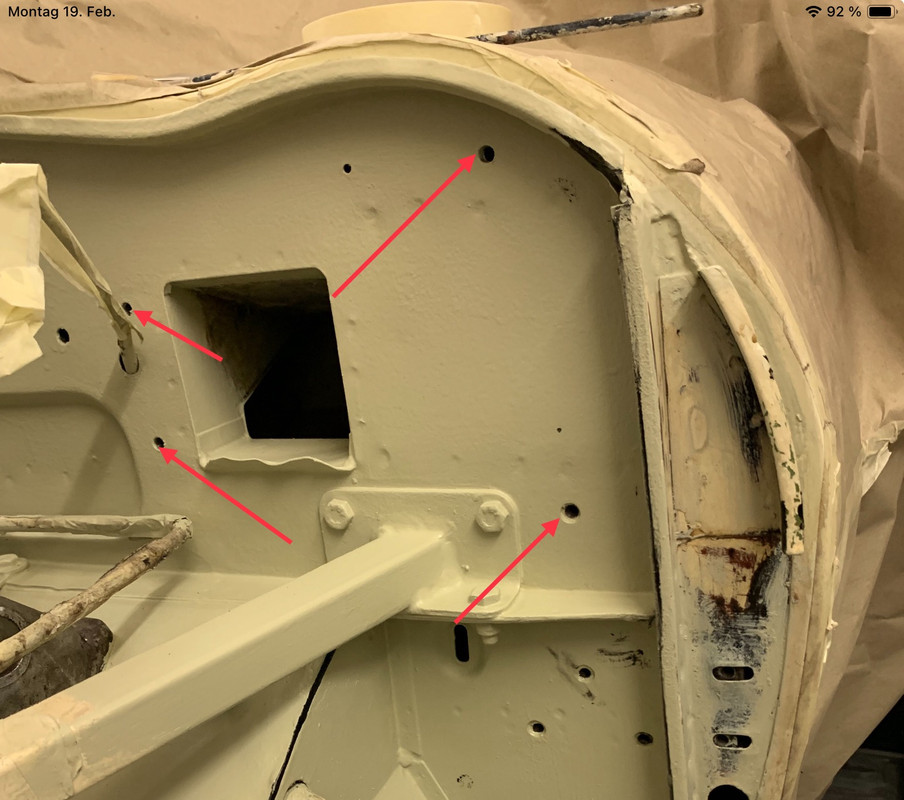

As you have correctly described, the heater box is attached to the bulkhead with 4 screws (see photo, red arrows). Last, but not least there is a flat gasket made of foam rubber between the heater box and the square cut-out in the bulkhead (part number C17308)
Good luck and have fun
Holger

That's just what I need - and the supplementary photos are a bonus. Many thanks.
This is also LHD: much of air con needs to be put back into service, so I will just move the relay to the original location pending getting on with the rest of it.

You need to understand one more "hole".
That additional hole is at 9 o'clock to the rectangular opening for the heater and i's larger than the 4x holes for the mounting bolts for the heater box.
This hole is for the two cables that attach to the heater box - one controls the flap (to open/close the air flow) and one to manipulate the heater control valve
Bonus - I drew this up to help me during my total restoration
Current status
Current status

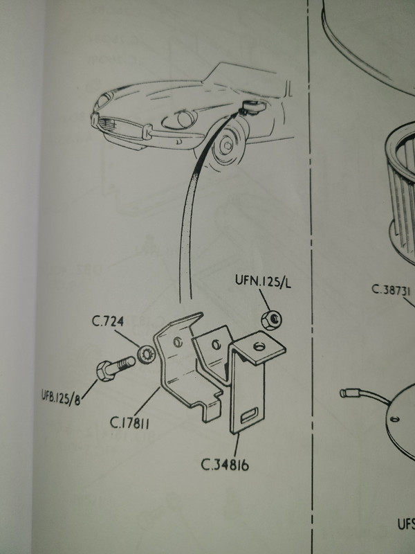

#5 Re: S3 Heater Install
Ooops - one more item

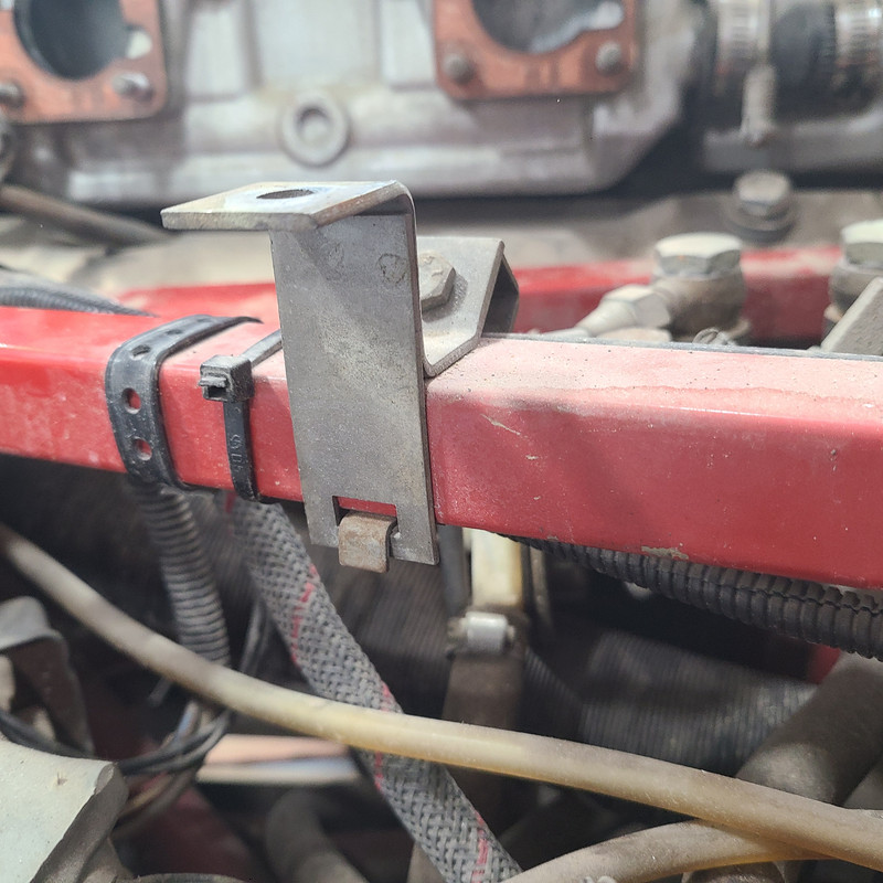

You're gonna find that the heater box is heavy.
You'll need this bracket to help support the weight(both parts of the bracket are available at SNG Barratt)
With my E-type still in pieces, I can provide more details. Just ask.

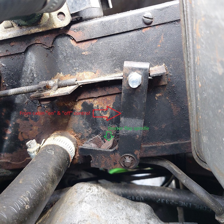

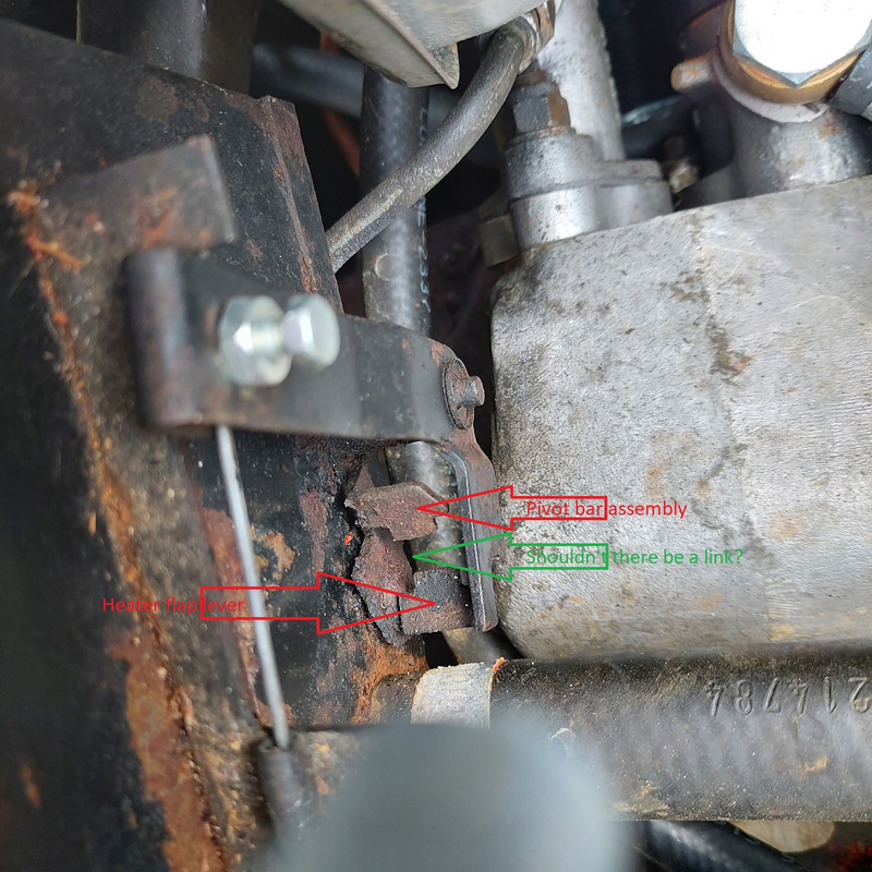

#10 Re: S3 Heater Install
Dear All,

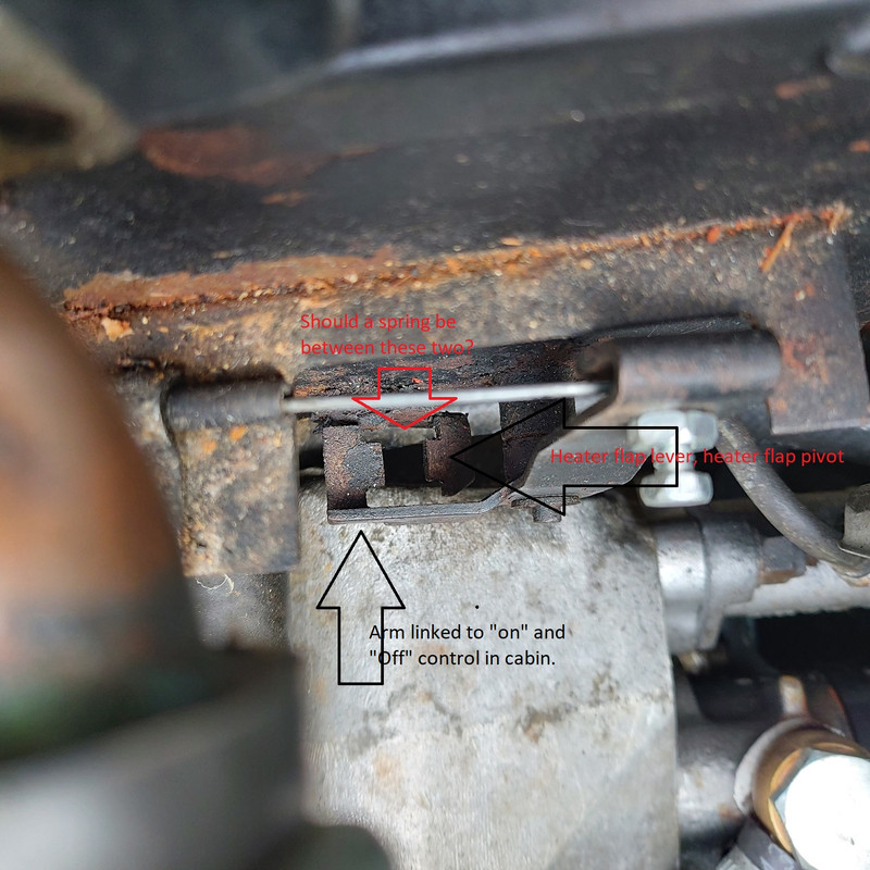

On this heater theme, I've just refitted mine after a brake master cylinder replacement and noticed there appears to be something missing. On the lower front righthand side of the heater box there is spindle that opens and closes a flap underneath the front of the heater box (described by SNG B as the "pivot bar assembly"). On the same side there is a lever described by SNG B as both the "Heater flap lever" or "Pivot bar assembly". Both shown on the photos of my car attached. What is not present is any linkage between the two. I assume there should be. Again SNG B list a "heater flap spring" that might be the link but from their diagram could also just center the pivot bar. At the moment when I actuate the "On" or "Off" lever in the cabin left of the heat control nothing in the heater box moves. I'm assuming that should control this flap? My contemporary repair manual sheds no light on this.
So any photos or info as to what should be between the lever and the flap greatly appreciated.

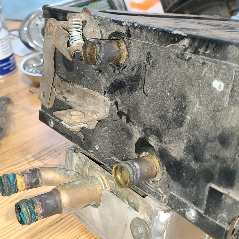

#11 Re: S3 Heater Install
There should be a thick heavy spring mounted onto the two red lugs where you have green arrow shown. When activated, it is hard to compress until it suddenly flips. This snaps the door open or shut and makes it change state.

#12 Re: S3 Heater Install

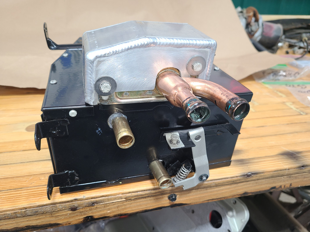

That spring is #31 on this diagram
https://www.sngbarratt.com/English(US)/ ... mbly/18222
Available from SNG Barratt:
https://www.sngbarratt.com/English(US)/ ... 202045400)
BEFORE
Better view - matrix on my bench up-side-down
AFTER
No Spring
Spring in place - on bench waiting for engine to be installed before installing heater matrix
CAUTION - that sucker is quite stiff and will readily launch across your garage into some obscure corner never to be seen again
