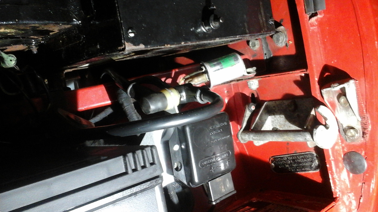

Hi James...here is mine under the heater on a 69 S2 2+2 it may help but sounds like you have already looked
.Steve

The 3AW relay sits to the right of the 4TR and is bolted to the body. The three wires for it emerge from the wiring loom around the same point as they do for the 4TR. Have a look for the the three wires, they may have been tucked behind the 4TR or even back through the grommet behind the 4TR into the passenger footwell.
The 3AW just works the indicator light and as you've observed has no connection to the charging circuit. However, if you just remove the 3AW the ignition light won't illuminate so your wiring must have been altered or the 3AW socket bridged to keep the light on.

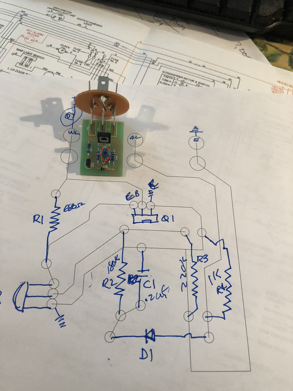

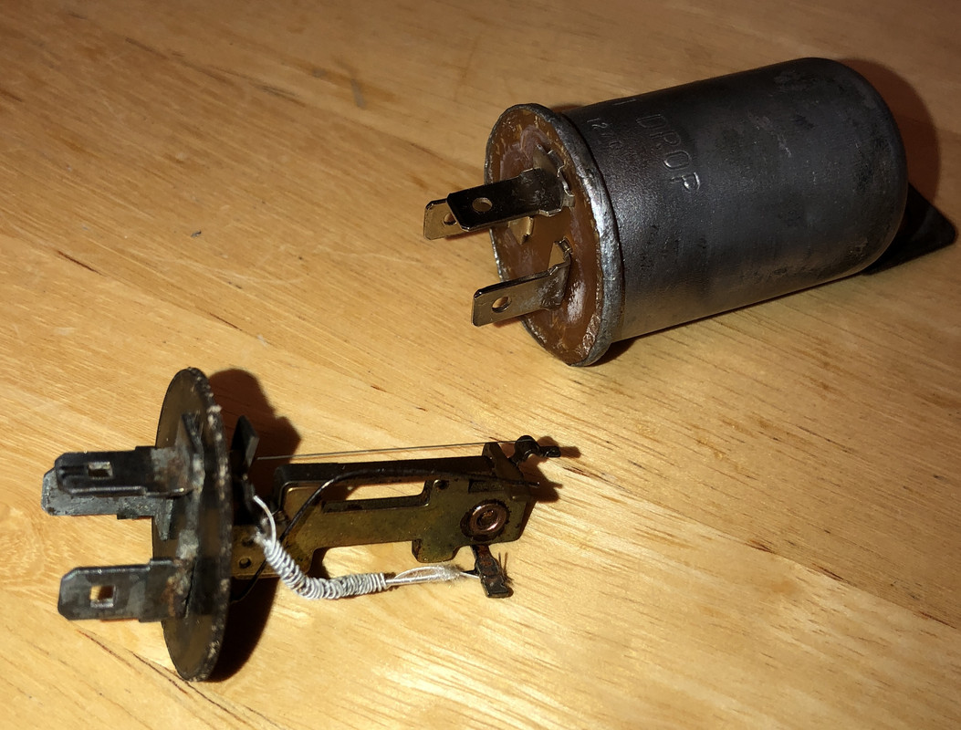

The 3AW electronic replacement from SNG does look like a can, but Aluminum... same size and shape as the original.
Dana

That was meant to be my point, also.. you can't tell if it is or isn't by looking... I rebuilt mine to look original with electronic innards readily available. Sorry for confusing.

#17 Re: Ignition Warning Light will not Extinguish
I think he meant my post http://forum.etypeuk.com/viewtopic.php?p=108695#p108355 above?mgcjag wrote: ↑Fri Nov 16, 2018 2:57 pmHi James...great that you have found the 3aw....can you please try to put your name and car model in tne signature area......i havent upgraded my 3aw....but you can get a solid state one that look original from https://www.sngbarratt.com/uk/#!/Englis ... 0d57f475f7 Steve
If so, yes that is the one I used also. With a bit of patience, you can relax the aluminum can's rolled flange, as well as the original can to take out the analog innards. What you are looking at in the pictures is the SNG unit's innards where I also changed the 0.2uf capacitor with a tantalum 4.7 uf to take care of random flickering of the ignition light at speed while I was at it. Works perfectly put into the original old container.

#20 Re: Ignition Warning Light will not Extinguish
One is an analog version, the other is electronic. The electronic one described above is what I replaced the original analog innards with. It works fine with the remote regulator and alternator original setup
