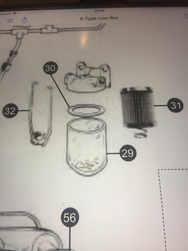

When I first had a blockage issue, I noticed the different filters. The Service Manual at C.14 has the gauze filter assembly (first image below), which seems identical to the current set-up but for a frisbee-disk gauze filter (item no. 41) instead of the concertina filter supplied by SNGB. The SNGB catalogue, for its part, has for the Series 1 only the concertina filter (hole on top, spring bottom) as part number C28080 (second image below). Mine is the SNGB filter (photo below).
I was advised, and seem to recall amateur searches corroborating, that the concertina was thought superior to the gauze disk and became the only unit supplied as after-market by the likes of SNGB.
Don't we now have Julian Barratt agreeing to weigh in where appropriate on things like this? I would appreciate advice as to whether I should try to move to the gauze disk and if so, what part number this is supplied by whom.
Also, please advise whether the particle residue shown on my pictures posted on 23 November above (in the filter bowl and on the paper towel after wiping) is of a normal or disconcerting quantity.

Hi Frank.....I will start a new thread in the Technical section on filters and see what comes up....will contact Julian SNG and ask him to look at it.........re your dirt in the filter bowl and is it acceptabel.......thats awkward to answer..as you know you want clean fuel into the carbs.....each carb also has its own filter..ideally the filter in the glass bowl should clean the fuel....but depends how bad tbe fuel is and how good the paper element is....I gave the link to show the options...Steve.....
