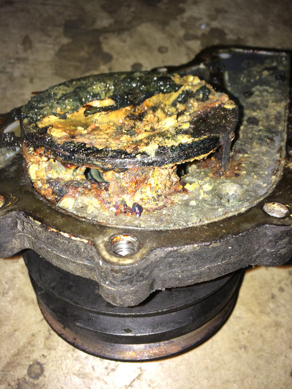

SNAP!
Here's my TOTALLY SEIZED crystallized V12 waterpump after three years parked in the garage with a dud radiator.

Don't really know. It wasn't clear water but I thought it more or less drained out because the radiator was leaking. I put the car away as soon as I got it home. It had been standing for about 25 years but the independent who found it had started to recommission it, including a coolant top-up at least, until he noticed a new radiator would be needed, which is when he bailed out. When I parked the car I'm certain the pump was silent and working, but three years later even a big Stillson wrench with a two foot Tommy bar wouldn't shift it and the belt squealed and soon smoked.
