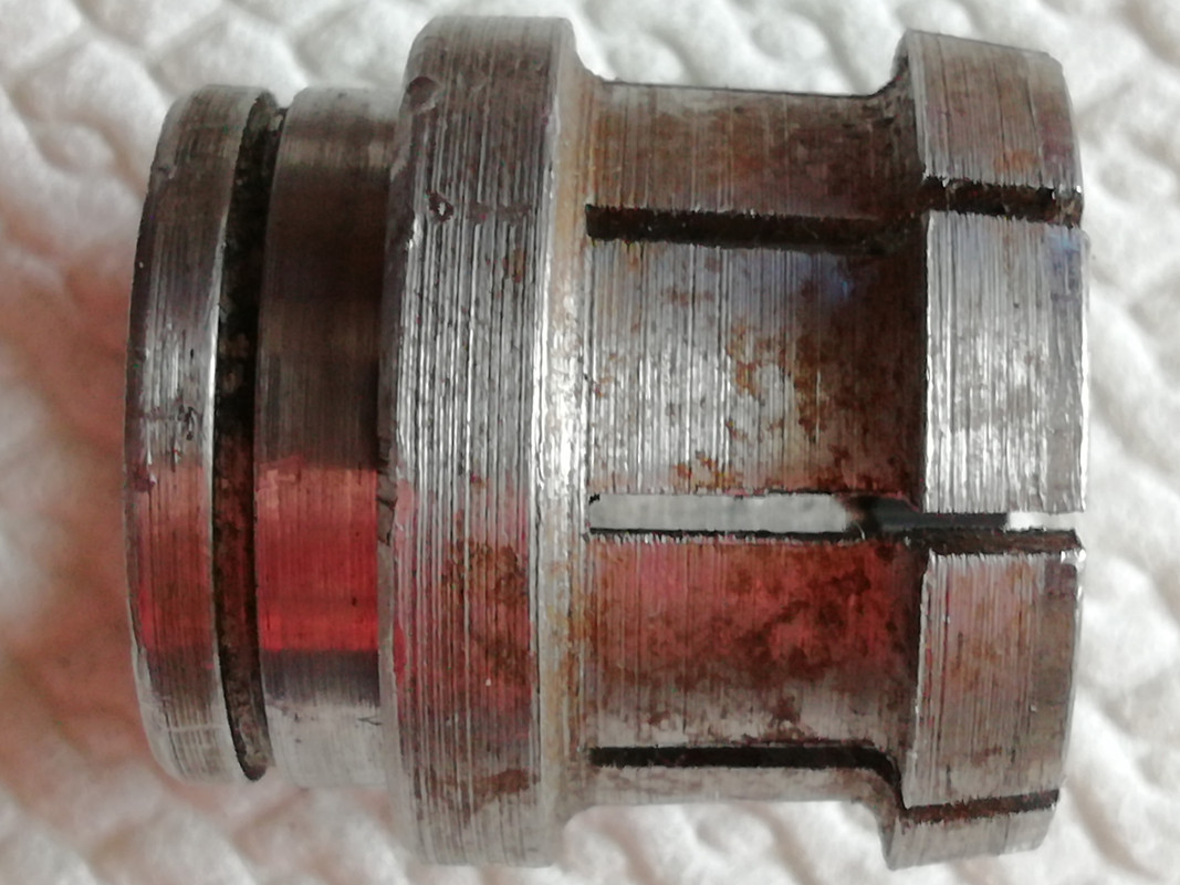

I disassembled the "affected" parts.
If I push down, by hand, the collet C8671, the shaft is difficult (almost impossible) to move with my other hand.
When I put the collet back into the black adjuster, and fasten it to a point that the wheels start to turn, but the shaft is just loose. The adjuster basically does not push down the C8671 collet deep enough.
I must say that the collet shows the impact of having been fastened plenty of times over the years.
Considering that the adjuster is on back order, I will try my luck with a new collet.

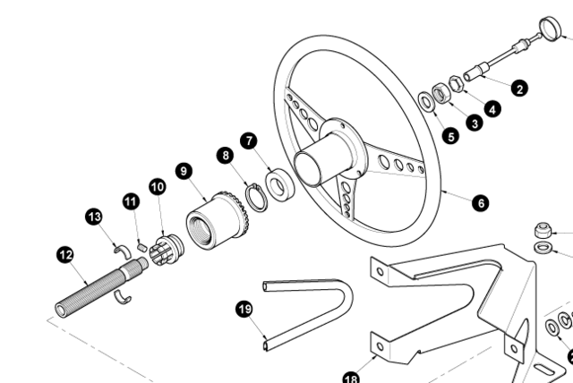

Hi Jan , by “adjuster” I presume you mean item 9 in the picture? If this isn’t available I definitely have several of those all vapour blasted and painted.
Hopefully it is just an assembly error. Let me have a look tomorrow what other spare individual parts I have.
#14 Re: Steering Wheel Locknut does not clamp
Indeed item 9. Will have to check also the thread of where it screws onto. Had the adjuster shot blasted and powder coated, and some other bits of the column, so it might just be an assembly glitch. Something for next weekend. Cheers
