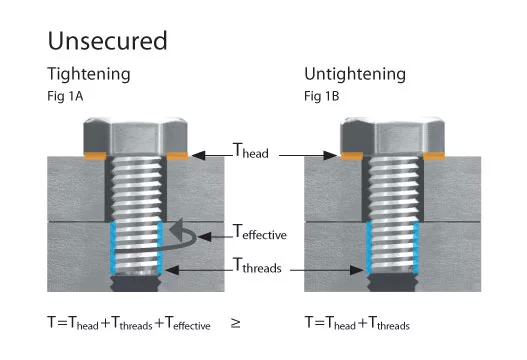

Copy from Nord-Lock grp who should know about fixings .....Steve
WHEN TIGHTENING AND UNTIGHTENING?
Saturday, September 17, 2016
Q: Why is the untightening torque lower than the tightening torque when tightening a bolt or nut?
A: When tightening a bolt or nut, the applied torque must overcome the thread friction, the friction under the bolt head or nut and the inclined plane of the thread, to obtain a bolt preload (see Fig. 1A).
While untightening, provided that the assembly remains in the same condition, the applied torque only has to overcome frictional forces. As a result, untightening a fastener requires a lower torque (see Fig. 1B).
There are some exceptions to this rule. Since friction conditions vary, higher torque can be required to untighten a fastener. Corrosion, seizing, or surface roughness can considerably increase friction and subsequently the untightening torque.

Thanks Steve. You saved me the trouble.
Schoolboy science is great for getting people interested in the subject but there's a whole lot more to engineering than sliding blocks down pieces of plywood.
