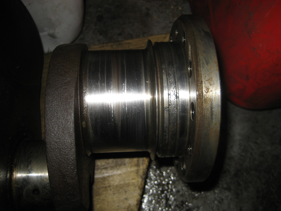

I am using a low mileage STD crank from an S2 Daimler saloon circa 1976.

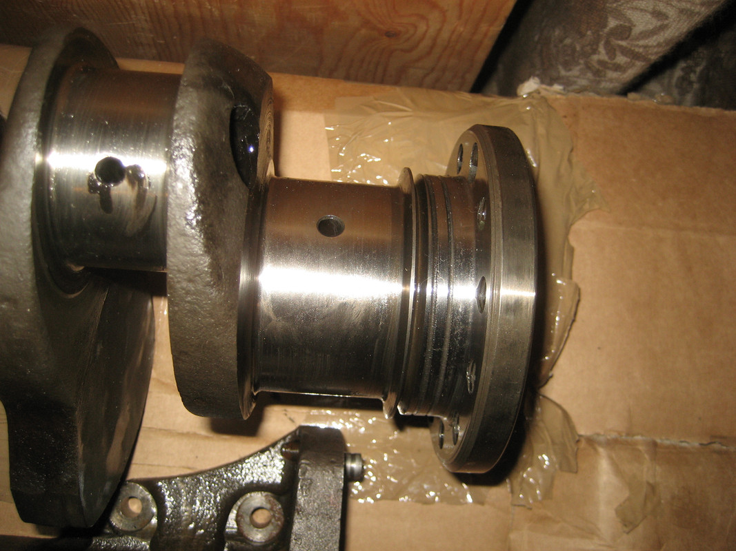

John, my engine builder has discovered the later crank has a scroll on the end journal which interferes with the standard bearings that I had had sitting on a shelf for years.

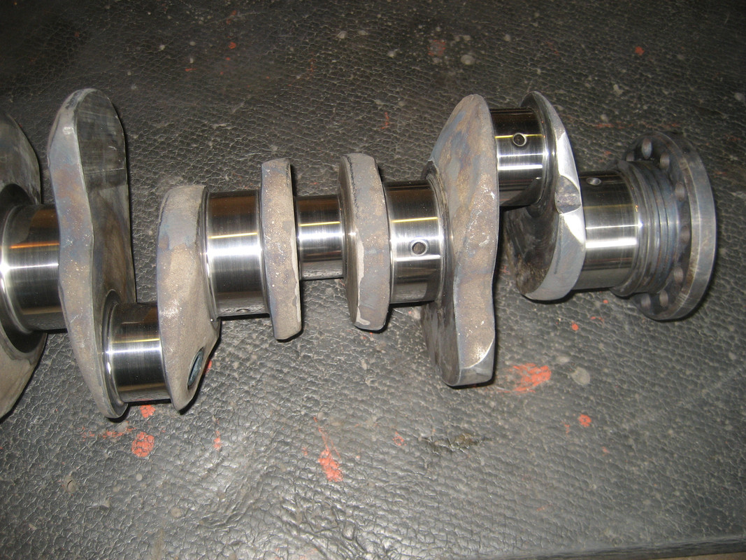

I could be wrong, but I am fairly sure all 4.2 cranks are interchangable.
I am not sure if this will help, but I bought a new crank from SNG which has a 10/69 stamp on the box MOD old stock I believe and it is identical to my 65.
And this is an XJ6 crank:

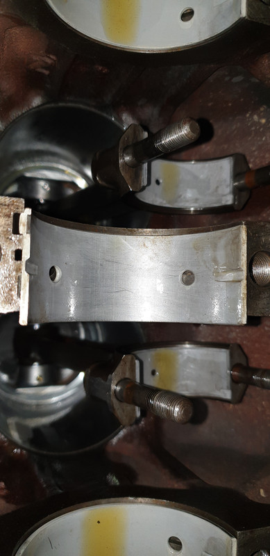

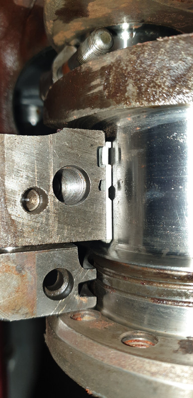

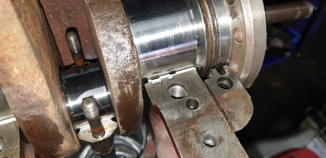

Couldnt find a number on the crank.
The problem is that one pair of bearings seem to have a misaligned tab.
Although the bearing locks into place, the bearing sits too far to the right.
The rest are ok.
The affected bearing is the end one near the flywheel. In other words the one that does all the work.
It pushes the bearing into the radius of the crank and the oil hole is misaligned.

Just spoken to David Manners,
They list one bearing set for all the 4.2 engines, so just bought a new set for £43.
These ones must be wrong.
I will compare when the new ones arrive.
James
L.J.K. Setright was right.

#7 Re: 1976 Daimler crank in a 1969 block. Main Bearings
Post by paulsco » Thu May 16, 2019 7:26 pm

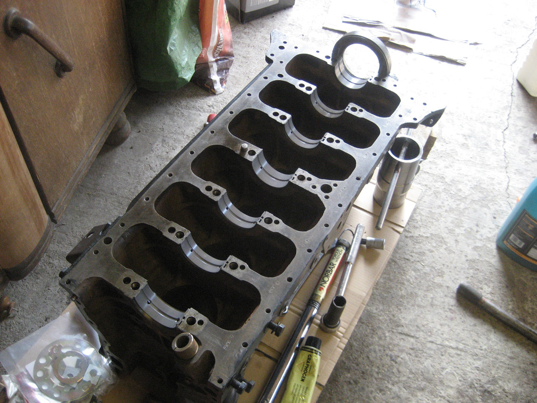

Hi James,
Have you put the cap bearings in the block? I think they are different.
The bearings that sit in the block are the ones that should have the grove down the centre of them, as in my picture above.
And the bearings in the centre are different from the ones at each end.

#8 Re: 1976 Daimler crank in a 1969 block. Main Bearings
Post by politeperson » Fri May 17, 2019 1:29 pm
Hi Paul,
They have been tried in all the combinations.
The rogue pair sit too far forward in all the positions unfortunately.
James
