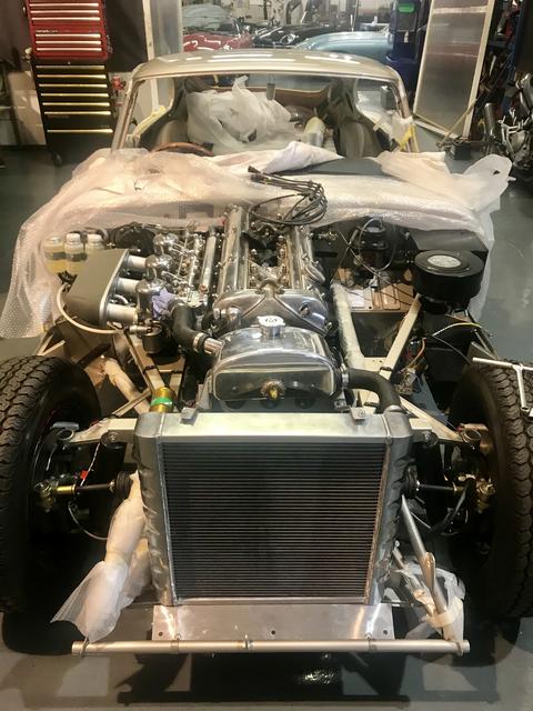

As my 3.8 rad was a bit leaky, and had the original flymo fan fitted, I went for an upgraded aluminium rad with integrated fan from SNG. No fitting issues and matched to a Cambs Motorsports curved polished header, looks great as well.
Hoping it performs as well as it looks.
