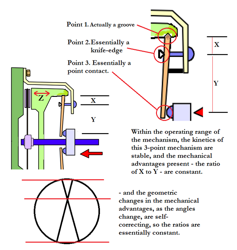

#13 Re: Clutch hydraulic gearing
Woolfi,
Here is how it works:-
Put simply, with a worn clutch, both of the yellow levers start out in a more horizontal position on the diagram so you have to push further to make them vertical to disengage the pressure plate from the clutch. (Assume pushrod freeplay is always adjusted correctly because that's what the manual tells you to do so.) What you have said is that your yellowy levers were too horizontal and you couldn't push them vertical because your foot didn't push enough clutch fluid down the line on account of the master cylinder bore being too thin.
Also, if a clutch is getting progressively heavier ~3000miles after you swap out a new master cylinder, check out whether the pushrod isn't scraping against the cylinder bore as it nears the end of its travel as it may not be travelling sufficiently in a straight line (it travels in an arc), or more precisely, in a straight line that matches the bore.
The clutch plate is outside the gearbox so its only link to gear change grinding has to be a reference to switching to or from a gear on the mainshaft which sticks out of the front of the gearbox and that shaft presumably never stops turning if the clutch does not fully disengage.
#14 Re: Clutch hydraulic gearing
Actually, it may simpler than that. You said you put a new pressure plate in. It may have had yellow bits which were simply at a different angle to that in the old one, or the leverage loss on one pressure plate may have been different to that in the other pressure plate. In the diagram, there looks to be about a 5:1 loss of leverage about the (light blue) diaphragm pivot - two different manufacturer's pressure plates may not be directly comparable.
Basically, it's a geometry problem.
#15 Re: Clutch hydraulic gearing
And also dont forget that as the clutch plate wears and moves the yellow parts more to the horizontal the release bearing will also wear...so canceling out to some extent the extra movement the release bearing would have to make to release the clutch.....Steve
#16 Re: Clutch hydraulic gearing
I think it's already in the analysis Steve.

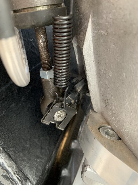

#17 Re: Clutch hydraulic gearing
Hi Marek and Steve, thank you for your help so far. Just one more thing......I think I have a major problem here with my clutch. I have put it off but I think I need to take the lump back out.
I think my problem (a very, very heavy clutch) is that this lever is so far back that the efficiency of the mechanism is compromised as the lever has already passed its optimum fulcrum point before I activate it, as your diagram above shows. See pic below, this is at rest and not with the clutch pedal depressed.
I have driven the car a few hundred yards and the clutch works but it is a monster to use.
As I mentioned previously, I have had the flywheel skimmed with a new diaphram clutch and fitted a new thrust bearing. I see elsewhere that these can come in various castings, some giving more throw, in so doing essentially moving the clutch actuating lever back towards the engine allowing for more movement.

Steve,
You've got a set of challenges here;
You may have fitted a release bearing that isn't tall enough
Your ex Toyota Supra(?) gearbox will have needed a clutch plate with different splines to a Jaguar one(?) leading to mismatched clutch and pressure plates?
That looks like an overly beefy spring on the clutch slave cylinder
Others can comment how far back the release lever should be but you're welcome to compare with mine.
A mini USB camera off eBay will let you see inside to check on the release bearing height BTW.

Hi Steve,
Whilst it appears that your problems are well and truly "upstream" of the release bearing, I wonder if the earlier diagrams might not already be usefully modified to represent more accurately what is going on inside the clutch, ie "downstream" from the release bearing.
To my mind, the essential point to grasp here is that the actual sizes of the X-Y mechanical advantage within the clutch are orders of magnitude greater than the very small Z dimension that represents the disengagement travel necessary to free the plate from the flywheel.
Therefore wear on the plate and faces have virtually no effect on the effort felt at the pedal.
Your problem indeed seems to come from an activating fulcrum, upstream of the release bearing, where the mechanism has gone way past its point of maximum mechanical advantage.
In this context, the travel of the release bearing is much more significant in relation to the sizes of the "levers" that are in play, and upsetting the intended geometry by starting off in quite the wrong place will have a much greater effect on the effort required.
To my mind the clutches that feel nicest are the one where you are initially pre-maximum mechanical advantage as you begin to operate the clutch, the mechanical advantage then going through its sweet spot roughly mid-travel, to meet the maximum load of clutch disengagement.
I am sure car and clutch manufacturers have hundreds of curves plotting the interplay between pedal movement versus clutch master displacement, itself a complex interplay, then slave to thrust bearing displacement - the one you're apparently struggling with - followed by the internal leverages across the clutch diaphragm spring that eventually produce the clutch separation.
Unfortunately this all seems to point to an engine-out conclusion !
