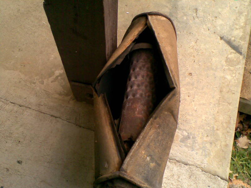

This is what happened to the exhaust of my landie when excess fuel from my Land Rover twin Strombergs got into the exhaust - bang - so I am surprised the OP did not have something similar if there was enough fuel in there for it to run out.

#37 Re: What Causes Petrol to Leak from the Exhaust
Garry Wrote:
I agree. The car at work was backfiring profusely, with flames shooting out the Fantail.
Hello Garry,so I am surprised the OP did not have something similar if there was enough fuel in there for it to run out.
