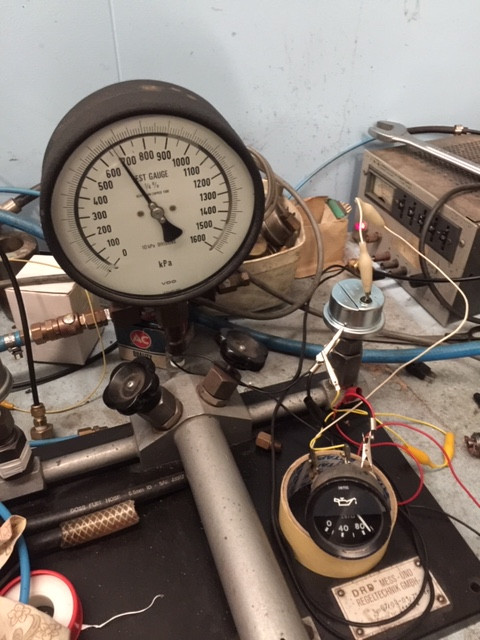

With confidence buoyed by the fading of memories of past failures I have embarked on the next great challenge, accurate oil pressure indication. Now I know that the consensus of the enlightened is to ditch the electric gauge in favour of a mechanical one, to the extent that SNGB now stock them as upgrades, but where is the challenge in that? This of course is the gauge in question, OEM Jaguar part number C33118:
Connected a variable resistance and measured the calibration, ohms versus indicated psi, the blue line in the graph below. Was a bit disconcerted by the nonlinearity, till I found this topic where Phil has measured similar (= orange line), so I guess that’s how it is.
Jaguar part number of the sender for this gauge is C31177. According to Smiths Instruments UK website ( https://www.smiths-instruments.co.uk/pr ... ransducers ) this is a PTR1811-10, which is what SNGB send when you buy a C31177.
Trouble is it never worked properly, was almost all the time pinned off the end of the scale except, when steaming hot and idling, it might drop down as far as 60 psi. And now it has died.
Smiths agent in Aus is Howard Instruments. Howard is a nice bloke, I send him pic’s of my gauge and my characterization data and he sends me pic’s of his test bench showing his recommended sender, PTR1001-10EC, making an old Smiths gauge read close to 100 psi correctly.
Until my persistence that this might not actually be proof of anything became irritating, then all he would send me was an invoice.
PTR1001-10EC sender duly arrived, hooked it up to the air compressor and measured its characteristic, the yellow line on the graph below. To read this graph, example as per the red arrows: Oil pressure, when it is 47ish psi, will cause the sender (yellow line) to have resistance of 180 ohms which will cause my oil gauge (blue line) to indicate about 13 psi. Not so good.

So if you hook up two of these yellow line gauges in parallel, then it'll halve their total resistance. Plot the new yellow line on the graph and you'll see it is now a reasonable match to the blue and red lines.
For example, at 30psi, the old yellow 240ohms now reads 120ohms; at 50psi the old yellow 165ohms now reads 82ohms; at 15psi, the old 290ohms now reads 145ohms, etc
There is little need to consider anything above 75psi in any great detail, as the pressure relief valve will cap the value.
MarekH
Posts: 1065
#24 Re: Oil pressure gauge
Post by MarekH » Thu Jun 25, 2020 2:56 pm
You can of course reach the same point by starting from the opposite end.
The sender has twice the amount of resistance wire that it needs for the gauge, so you could make the parallel argument (adjustment) at the gauge end instead - drive two gauges, one of which is left hidden. That way, the proportion of voltage drop between gauge and sender is brought back the required equilibrium again.

I was delaying reply to this post. My sender and gauge are still with Roger Howard of Howard Instruments, Caerbont Aus agent. Melb stage 4 restrictions have locked them out of their premises. Last report Roger was finding it was the age of the gauge was the problem, needed to be recalibrated. This seems plausible, explains the unexpected non-linearity of the gauge characteristic, compared to the new sensors linear characteristic.
