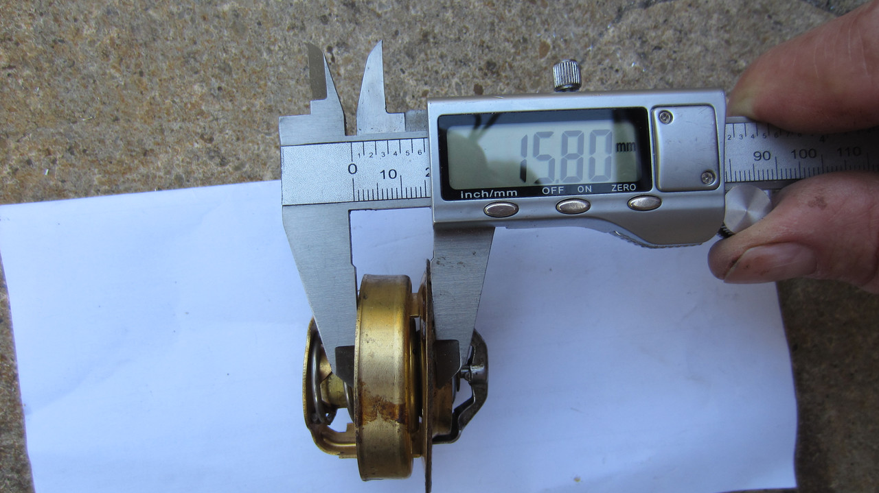

#25 Re: Am I overheating?
Hi All,
I have noted all your comments and am working through them.
As the engine had been running normally until lately I decided to start with the things I had changed. I had the old thermostat (which I tested) and a spare gasket and it only takes a short time to change, I thought I would start there.
I need to re-read the thread on thermostats, because when measuring the thermostat sleeve (on the correct thermostat), I found that the sleeve sits further down the bore than the bottom edge of the slot in the manifold, so in theory blocking it off even when cold.
From the top of the thermostat to the bottom of the sleeve is 15.80mm; from the face of the manifold to the bottom of the slot it is 14.52mm.
I say blocking off in theory, because the sleeve is 46.41mm in diameter and the bore is 48.81, so there is a gap between the two of 2.40mm.
It would seam that the sleeve needs shortening by about 1.50mm, but as there is a gap anyway it is debatable.
Anyway, I changed the thermostat, but this had zero effect

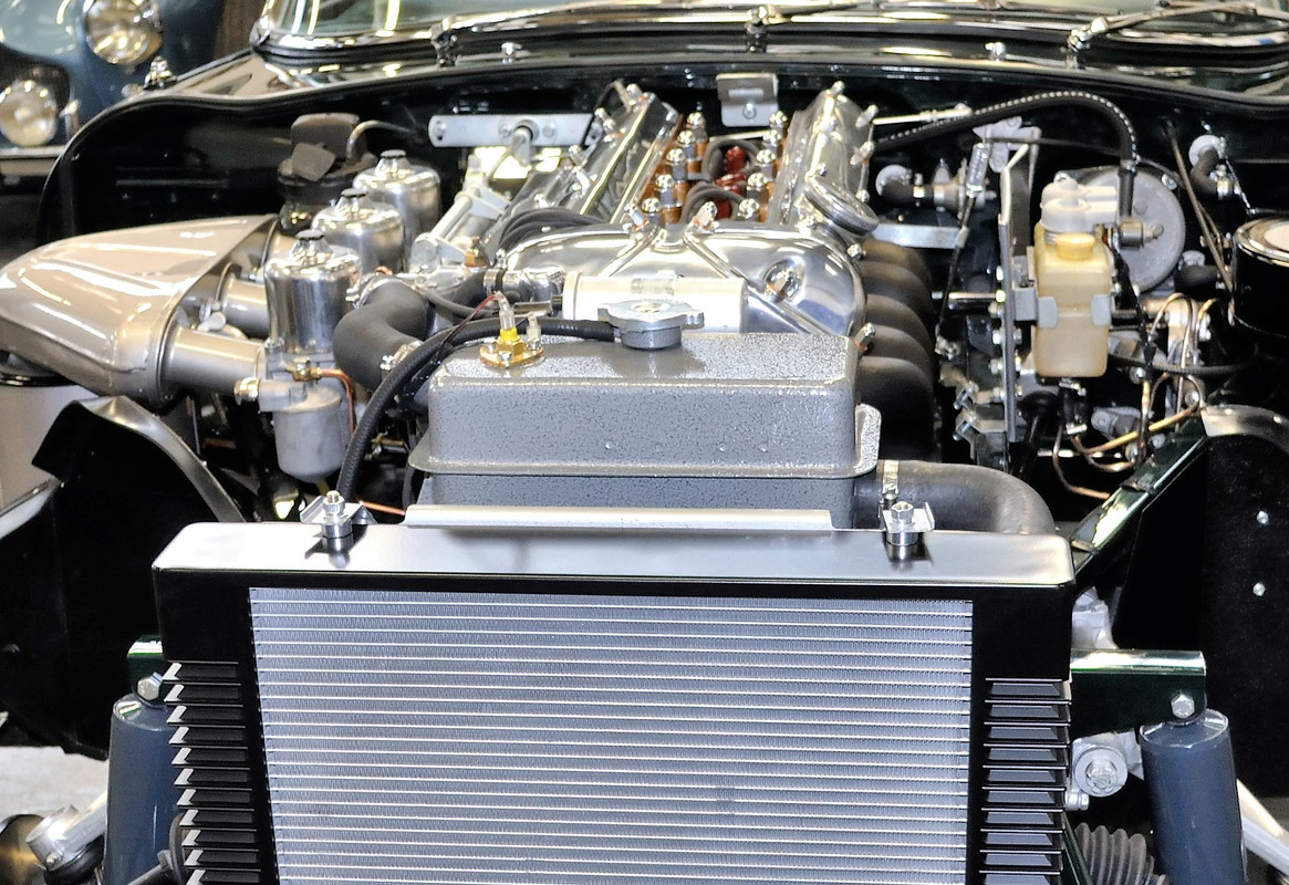

I started looking at the header tank as I could not envisage how it was intended to work. It has hoses to both sides of the radiator as well as the one to the inlet manifold.
My tank is just that, an empty tank with three pipe connections.
I have discover that there should be more to it than that and the hose from the inlet manifold via the thermostat should be piped internally across the header tank to the top hose and have a small cut out in the middle where the otter switch pokes through.
viewtopic.php?f=4&t=2733&p=17921&hilit= ... ank#p17921
https://forums.jag-lovers.com/t/s1-purp ... s/361660/5
https://forums.jag-lovers.com/t/s1-4-2- ... /386383/17
I am now wondering if I need to buy a new header tank with the correct piping and also fall back on the old type of otter switch which would come in at a lower temperature (more head room for AC) and also the new style of switch does not fill this hole in the internal pipe as well as the original, so the hole would leak more into the body of the tank and possibly be less efficient?

I'm not sure what set up you have but, for a 3.8:
The header tank shouldn't be an empty container and I believe that is your issue. The water passes through the top hose and you need that to go across the otter switch. If the water is just pouring into the header from the top hose, then it's probably not passing across the otter switch so, the otter is not working correctly.
I'd expect that as the water pours in when the thermostat is open, that it contacts the otter switch sensor and when it reaches the temperature, the otter switches the fan on. Later when the fan has cooled the water, the water pouring across the sensor is cooler and the switch turns the fan off.
Forgetting the generally inaccurate temperature gauge readings have you tried hard wiring the fan to run all the time? If the car doesn't overheat then I'd suspect the header tank not directing the water to correctly contact the sensor. I think this is the conclusion you've already reached but remember not to overfill the system as it will probably blow off some antifreeze and that will look like overheating.
Good luck, Chris
Good luck, Chris

If your header tank is empty, then that probably explains your overheating problems. The coolant will be bypassing the radiator matrix and only flowing through the right hand tank and back to the water pump.

Thanks Chris and Tom, that was my thought.
Strange that it worked before. The trouble is I have been altering one thing or another over the period of this rebuild and I cannot remember at what point the problem developed.
It is probably when I fitted the Coolcat type otter switch, which is supposed to be 85/80C, but I have seen posts where people have said it comes in around 90C.
This combined with my empty header tank quite possibly pushes it over the top.
I am in the process of reverting to a standard otter switch and a few other things, at this stage short of the expense of a new header tank to see if these help.
I know eventually I will have to bite the bullet and buy a new tank though. The expense being that I don’t want a steel one :-(

Can you post a picture of your Header Tank & Radiator connections? On my 3.8, the Header Tank should simply have two connections (apart from the overflow vent hose). Looking front-on, the Left-Hand pipe goes to the Inlet Manifold and the Right-Hand hose goes to the radiator (see photo below) There will always be water in it (to an inch or so below the top of the tank).
