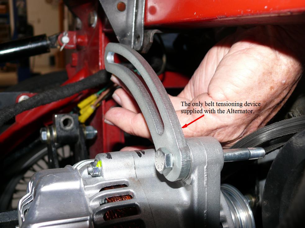

#6 Re: Fosseway V12 Alternator Kit
Hello All,
Of all the Alternator alternatives to the B.U.T.E.C. I've seen, the components for mounting the Alternator to the Alternator/Air Pump bracket are satisfactory, but the Belt Tensioning Device is rubbish.
The Tensioning Bracket shown in the following picture as part of the fitting kit supplied by one of the usuals, is close to nothing on the engine without making some "Heath Robinson" component to bridge the gap.

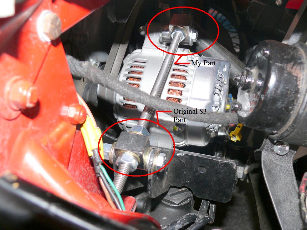

The following picture shows an Alternator installed using the components I manufacture to replicate the original method used with the B.U.T.E.C. It uses the original Jaguar Part at the outboard end of the rod, with my part attached to the Alternator.
The following picture shows the detail of my part. Threaded Rod was used when prototyping the assembly. I now use a rod threaded at each end only; I think it looks more purpose built than using Threaded Rod.
