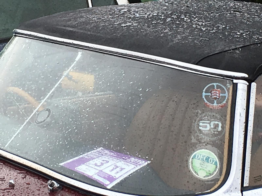

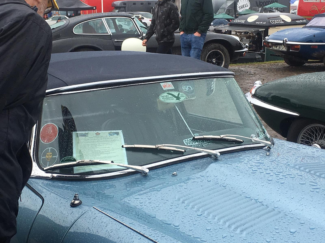

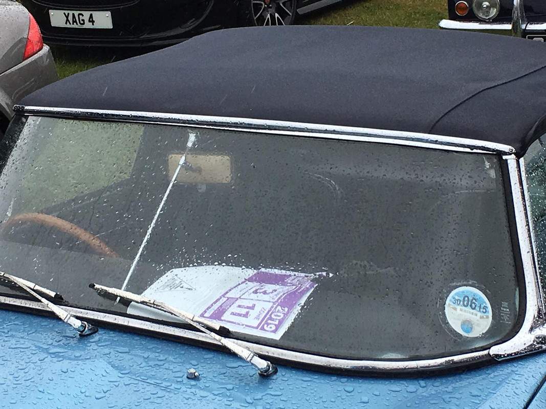

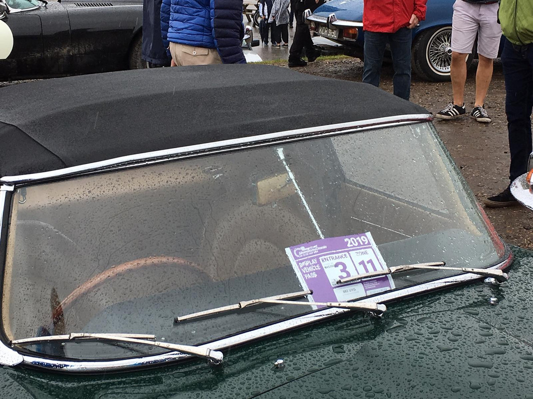

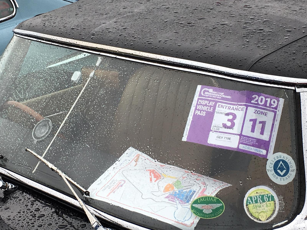

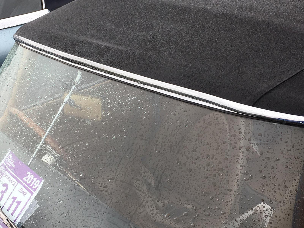

Had an interesting trawl through some cars on the hummock at Silverstone last week, here are twelve examples of what the wrong overlap looks like, with abject apologies to any owners concerned.
My car has lots of faults, but just not this one.
It's hard to get right ; there were only twelve cars up there ...............

Didn't think mine was too bad although the picture reveals a fault but as it doesn't leak i will leave well alone! I just wish I could stop the leaks from the doors onto the cills. Does anyone have any tips on this as I am running out of ideas?
