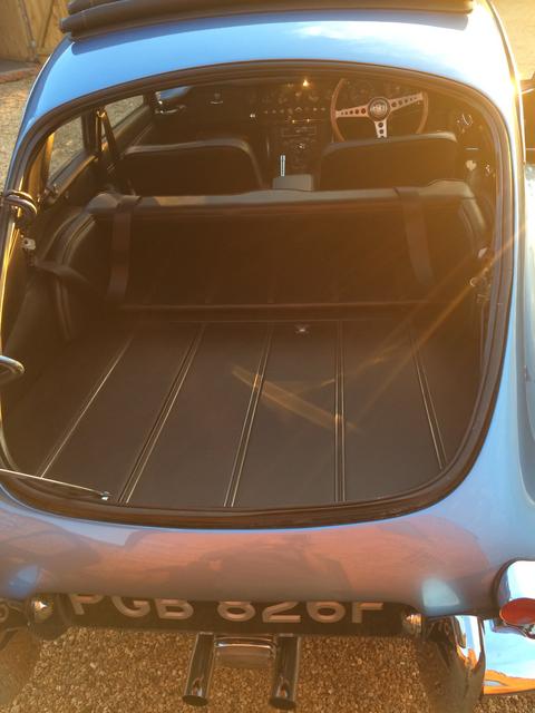

Ive started the boot boards. All but one are re usable. Ive also re used the luggage strips but have replaced the rubbers as these were completely brittle and crumbled as I removed them. Im using 3mm neoprene foam rather than sponge as I prefer the way it keeps its shape rather than 'pillowing' like the old sponge was. (Does that sound a bit obsessive?!)
Anyway, Ive managed to set myself up in a space inside the house and Im quite enjoying myself!
Before and after (hopefully you can see which is which!)

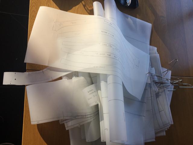

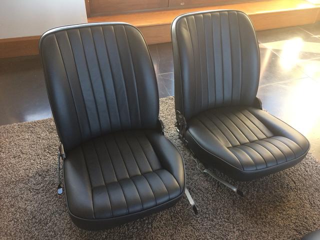

Well, progress has been steady you might say, an engine rebuild along the way, but the seats arrived today. As mentioned, a friend of mine is a recently retired OEM seat specialist. He kindly agreed to take mine on and the results are fabulous. He started with the existing covers which were stripped and new patterns made and improved. He has also covered the frames with foam to leave completely smooth surfaces on the backs of the squabs. His attention to detail is obsessive to the point of every flute being exactly the same width with cushions aligning to squabs perfectly. I was also lucky enough to have a mate who got me some beautiful, semi aniline leather which is super soft and smells terrific. The heat is on now on for me to make the easier stuff look as good!
V happy!
PS can anyone suggest a source for replacement seat mech covers??
Half of the patterns!
