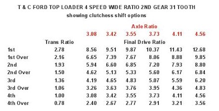

Seems Laycock de Normanville became the overdrive division of GKN which was bought out by Gear Vendors (GV). GV still produce these units and market them as under/overdrives, to emphasize the opportunities/benefits of using OD in all gears, called “gear-splitting”.
GV website: https://www.gearvendors.com/index.html
One of the many gear-splitting example from GV website:
One of the magazine articles reproduced on GV website, in this one they say that early LdN Od's weren't that strong …
https://www.gearvendors.com/rodandcustom-sep05.html
