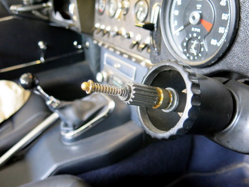

Post by Heuer » Wed Aug 08, 2018 11:10 am
This is what it looks like:
Suggest you dismantle the shaft and give everything a good clean. Basically the white ring clip sits over the shaft where the hole is. The small brass nipple fits into the hole, the spring goes on top and the brass collar holds everything in place. When the long thin inner brass rod is in place the nipple is in permanent contact with it regardless of rotation. The copper contact completes the circuit.

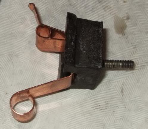

The original contacts were beryllium copper which is a good spring material. The new ones are regular copper, which is not. The BeCu will stay in contact, regular copper will relax to wherever it's held and not spring back. Hutsons sell ta repair kit if you need it. This is the repro copper contact to be wary of so try and reuse the original:
