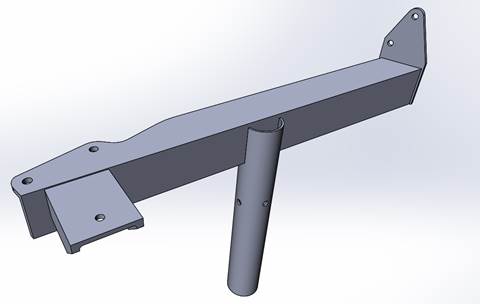

PS Your engine stand looks like it needs one of these :
http://forum.etypeuk.com/viewtopic.php? ... 47#p106647
