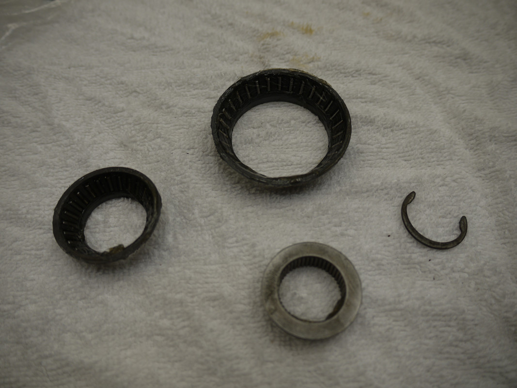

Hi Julian...not sure were talking about the same thing....the upper bearing im talking about is tapered on the inside and outside....it is a plastic cage with metal rollers inside.....so i need the cage..or similar complete bearing....the usual suppliers have a replacement part but its not rollers it solid....this is a photo from Chris Vines Blog the plastic cage,s seen at the bottom just left and right of center....Steve

#16 Re: Upper Steering Column Bearings
Post by Julian.P » Thu Nov 22, 2018 9:31 pm
Hi Steve, that’s the same as my column, I reused the plastic cage as the old needles just press out and refitted my modded needles into the old cage, it was simple todo and only took me a couple of hours to compleat.
Hope this helps, Julian.
Posts: 4140
#17 Re: Upper Steering Column Bearings
Post by mgcjag » Thu Nov 22, 2018 10:54 pm
Hi Julian...its the plastic thats broken up that needs replaceing.....Steve
