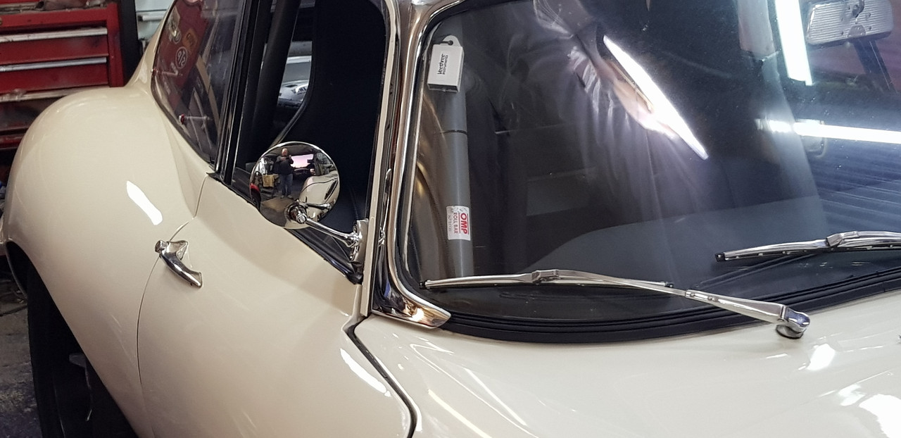

I'm using the Tex clip-on, but modified the mounting such that it slides/loops over the leading edge of the window frame instead of gripping from the trailing edge. This keeps it somewhat attached even if it should come loose. The modification involved slicing the bracket lengthwise, and welding in a spacer. Then flip the bracket around as described above and shown in the photos. I like the design because it doesn't clutter the lines of the car. I believe Tex is a UK company...I got them from XKS in the U.S.
