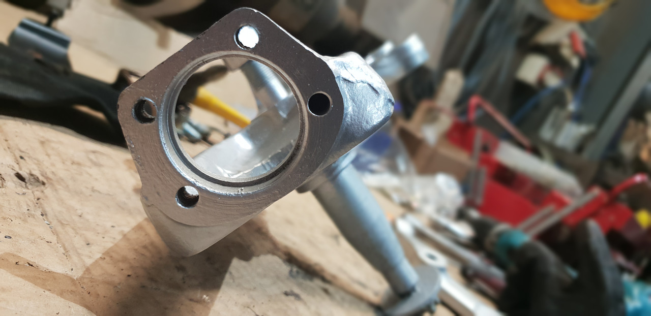

Hi Mark..is this what you have
This is not my photo just one off the web..note the lip on the ring that needs to come out...i posted above to knock it out upwards if on the car....you have now made me dought myself....just have a good look..measure if needed it should be obvious....im sure its upwards.. Steve
Posts: 886
Location: Boston UK
#11 Re: Series 1 front hub carrier help required
Post by politeperson » Sat Feb 09, 2019 5:09 pm
You knock it downwards to get it out!
Here is a picture of the bottom of the carrier. You can see the retaining lip quite clearly once the ring has been removed.
The problem is the top edge of the ring gets peened over the hub carrier by the ball joint over time, making it difficult to knock it out.
The last ones I have done have required me to use a hacksaw to carefully cut through the ring so it can be tapped out with a punch. (downwards)

Great thank you very much. I think the hacksaw trick will be required for mine to
Many thanks again both
Pethers
Posts: 20
Joined: Sun Aug 12, 2018 12:20 pm
#13 Re: Series 1 front hub carrier help required
Post by Pethers » Sat Feb 09, 2019 6:01 pm
An update......it’s out! Thank you again
